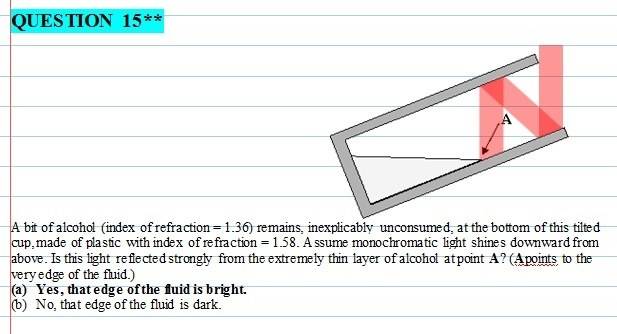

Perhaps just a geometric problem?
so perhaps the index of refraction does not matter?
From that question, I wouldn't say so .. I assumed it continued to asking something else later on, more relevant to the refractive index?
lol no. This was a practice exam and half the people got it wrong. I guess the teacher was just being tricky.
Very sneaky!
Well, from how it reads, I'd say that's the right answer
Think of phase change at both boundaries: air-alcohol and alcohol-plastic. What is the phase difference between the wave reflected from the alcohol-plastic interface and the directly reflected one (from the air-alcohol interface)?
