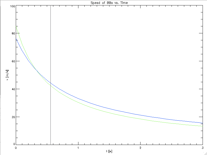

blackhawk
I've been having a discussion with some friends at a local Airsoft club for some time now and we are unable to agree on the flight distance's of identical objects that have different masses. I'll try to explain...
If a 6mm spherical object, weighing 0.2g, was fired on a horizontal path with a muzzle velocity of 350 feet per second (we've worked that out as 1.14joules?), given normal atmospheric pressure, gravity and let's say a muzzle height of 60 inches.
And then have a second identical object fired with the same statistics but it weighs 0.25g and fired with the same energy 1.14 joules (we worked out the FPS would be 313).
Now half believe the .25g would travel further than the .2g due to the momentum how ever half believe the .2 would travel further due to the higher velocity?? Can anyone help me with working out how far that object would travel before it hits the ground (resulting bounces are of no interest) or explain which one has the greatest travel distance and why? Many thanks in advance!

What you'd have to do is plot velocity versus time for both objects, then calculate the distance which is equal to the area under the curves (integrate the velocity versus time equations) from time the objects exit the muzzle till the time they hit the ground.
Although the lighter object has a higher initial velocity, it's slowing down at a faster rate (even when at the same velocity), due to having less mass but the same area (same aerodynamic drag). I don't know which will travel further.

Yes, and that's basically the approach that I took to solving this problem. I assumed that there was drag in the horizontal direction, but no drag in the vertical direction. MAYBE this is a good approximation, I don't know. After all, the drag force is proportional to the speed squared, and the vertical speed is much less than the horizontal speed. So maybe we can neglect vertical air resistance and assume that the BBs are in free fall. Doing that, I got the following result for the horizontal velocity of the projectile vs. time:
[tex]v_x = \left[\frac{\rho A C_d}{2m} t + \frac{1}{v_{0x}}\right]^{-1}[/tex]
where [itex]\rho[/itex] is the density of air, A is the area, m is the mass, Cd is the drag coefficient, and v0x is the initial (starting) horizontal velocity.
I used that result to figure out what the position of the projectile vs. time would be. It is given by the expression:
[tex]x =\frac{2m}{\rho A C_d}\left[\ln \left(\frac{\rho A C_d}{2m} v_{0x}t + 1<br /> \right) \right][/tex]
where ln is the natural logarithm. I have included my derivaton of these results below (at the very end of the post). I don't know if you'll get much out of it, but I've included it for completeness, as well as in the hope that somebody around here will catch any mistakes I might have made.
Plugging in numbers gave me the results that are tabulated below. As you can see, my numbers differ from his quite a bit. That could be because I solved for it exactly, whereas he used some sort of approximation method. Or it could be because what he did is just entirely wrong (or it could be that what I did was wrong).
As you can also see, I've attached two plots, using the same colour convention as him, where the green curve is for the lower mass BB, and the blue curve is for the higher mass one. I've included a vertical grey line that represents the cutoff time of 0.6 seconds (the time required to hit the ground). Everything to the right of this line is irrelevant. As you can see, although the green (less massive) BB starts out with a higher velocity than the blue, it decreases faster, and there is a crossover point. This crossover point occurs BEFORE the cutoff time. Therefore, the more massive BB IS moving faster horizontally when the two projectiles hit the ground.
In contrast, the distance vs. time plot shows that the crossover doesn't happen until after the cutoff time. So, in this case, the less massive (green) BB is always farther along than the more massive (blue) BB, just like in the vacuum case. This means that his conclusion at the end of the article that the more massive BB is better for shots greater than a certain distance is dubious, given that those distances are beyond the range of the rifle in the first place! Clearly it was important to take gravity into account. Of course, if you started with a larger height, the vertical grey line would move to the right, meaning that in some situations it might be possible to get the crossover to occur, and the more massive BB will travel farther.
So, my graphs are qualitatively the same as his (they show the same general trends), but our numbers are not the same. I'm very curious to know how he went about solving the problem. Maybe you could e-mail him with a link to this thread and see what he says?

Comparing this to the graph in this article.
http://www.grc.nasa.gov/WWW/K-12/airplane/dragsphere.html
this puts the Cd in the flat part of the graph at about .5 for reynolds number from 5,000 to 110,000.
Although the time to fall 60 inches is .557 seconds, the range of the air rifle includes the case where the rifle is aimed upwards slightly. Even a shallow angle will allow the BB to reach a peak height about 4 feet above 60 inches, increasing the time by about 1 second.
I understood everthinng up until the complex calculations :) thanks for the clear, informative write up and graphs!
I shall drop them an email with a link here to see if they can shed some light onto how they came to those results.
Would it be possible to do those same calculations but with a starting speed of 350 and 313 FPS? I would have a go myself but I'm afraid I don't even know what some of the symbols mean. Yet again thanks everyone for taking the time to help me with this.
