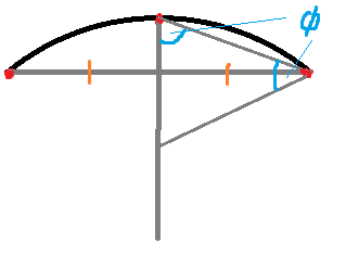

How can I find the radius of a circle by knowing two points and its arc length? Do I have to use a numerical method to solve for a trigonometric equation or is there any algebraic or geometric method?
Orient the two points to lie on the horizontal (just makes description easier) and draw a line between them. The part of the arc that lies above halfway along this line is now a third point, draw a line vertically down from this point. Now draw a third line from one of your two original points to the new one drawn on the arc, the angle this new line makes with the vertical is the angle a fourth (and final) line needs to be drawn at from the other end of your newest line towards the vertical one to form an isosceles triangle with the two equal length sides being the radii.
Attached is an image which I'm sure will be easier to follow

If by the radii you mean the two segments marked with the orange lines, then no, that's not the radius. You can't just assume that the segment of arc that you picked forms half the circle.

Thank you for the reply but as you did not use the length of the arc it is impossible to reach a solution by your way. Actually there are number of mistakes but I am sure you can notice them at a second glance. Again thank you for your effort.

No, the two angles marked [itex]\phi[/itex] form the base of an isosceles triangle who's equal sides are the radius, the two lines marked with orange lines are just of equal length.

But the arc length has been used, [itex]\phi[/itex] will become smaller with a larger arc length and larger with a smaller one.

Nonsense.
Try your technique with an arc length of 14.1897054604163922812851617102553083 and the two points being the origin and (14,0). There's no room in that picture for the radius of the circle (which happens to be 25 in this example).
D H said:
Nonsense.
Maybe I didn't explain well enough because my method gets 25 no problem, taking your values I found the segment height (using a calculator online) to be 1, this gave me a base angle for my isosceles triangle of [itex]\tan^{-1} 7[/itex] and a base length of [itex]\sqrt{50}[/itex] which therefore gives the equal sides a length of 25 each.

There's no escaping that solving this problem will require solving a transcendental equation of some form, and that is what uyger asked in the original post. (He just didn't know that that was what he was asking.)
