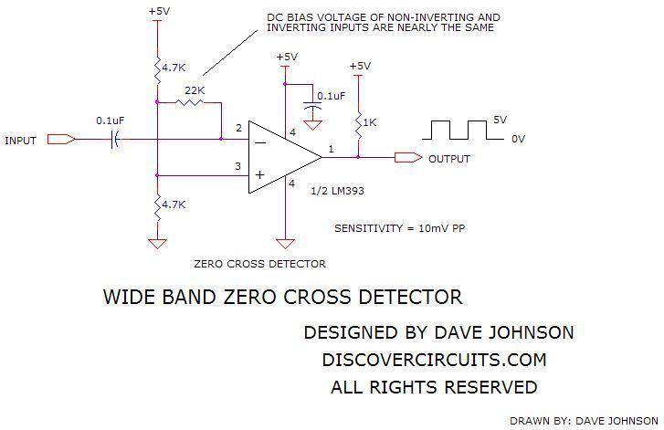

A zero-crossing circuit actually produces a square wave, high to low and low to high transitions take place at the zero crossing of the input sine wave or a noisy sine wave. You'll still need some type of microcontroller to read times when the transitions ocurred. You can build the zero-crossing circuit using any simple analog OP-Amp or comparator chip. Highest frequency I have seen such a circuit can handle is 140KHz.
I tried to attach a jpg but doesn't seem to work. OK, it may be working

A single zero cross detection circuit won't give you phase...as has already been stated, phase is relative. Two zero cross detectors and a reference signal will give you phase, though, as the difference in zero crossings. You will need to treat the rising and falling edges differently to handle the full range of possible relative phases.
