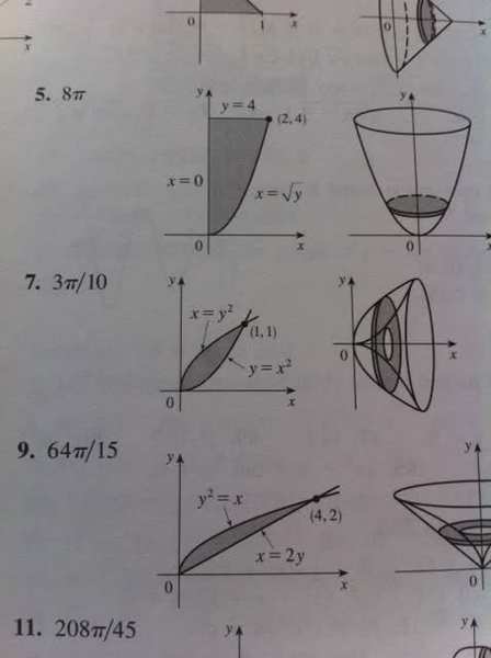

Find the volume of this equation, revolved around x axis
y=x^2
y^2=x
1) (pi)(r^2)
2) r = x^2
3) (pi)((x^2)^2)
4) (pi)(x^4)
now to integrate
5) (pi)(1/5(x^5))
since x = 1, and 1^5=1, 1/5=1/5
pi/5?
there are two equations here (y=x^2 & y^2=x), are these two somehow combined for the result
the answer is supposed to be 3pi/10
thanks.

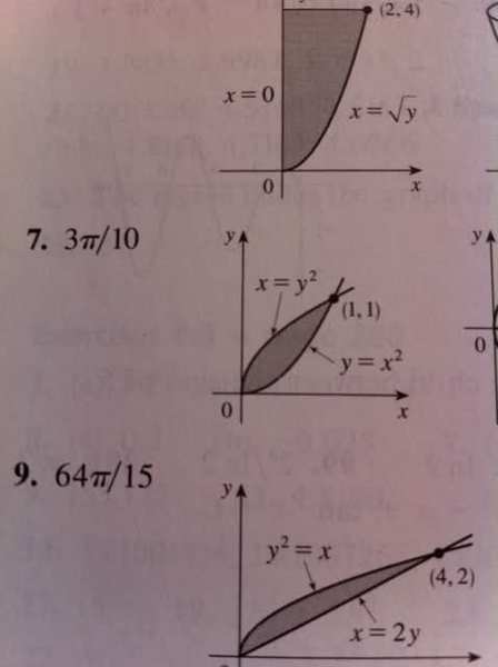

yes the question gave me those two equations specifically. The picture of the answer shows two curves.

Have you sketched the graphs? Are you finding the volume of material used in molding the walls of that 3D object?
Perhaps you should post the solution.
question 7
But you've cut off that part that was going to answer my question! :cry: :cry:
lol sorry
Okay, so from the solution we can see that the question does indeed require that you, for example, find the volume of clay needed to make the walls of that aforementioned jar. :cool:
Now that we all understand the question...are you right to finish it?
obviously not
It might be clearer if we attack this in two steps:
① Find the volume of the generated solid enclosed within the outer curve (viz., x=y²) for 0≤ x ≥1,
② Find the volume of the generated solid enclosed within the inner curve (viz., y=x²) for that same domain.
Finally, subtract these volumes to determine the difference.
The volume of the disc shown shaded in your figure is a circular-based cylinder of thickness dx. For the moment, let's forget about the hole in the disc. At any distance x, the circular face of that disc is of radius = y. Using the area of a circle formula, and the thickness of the disc, what is the expression for the volume of just that thin disc shown shaded? (No calculus is involved in answering this.)[/color]
