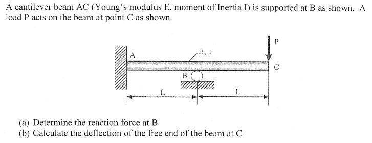

Hey Guys,
I need help understanding how to find the deflection of the following cantilever beam (in the image: capture).
There a beam with a fixed end (point A), and a roller support halfway on the beam (point B), I need to find the deflection at the end of the beam (point C).
Can someone just double check that I've done this right:
To find the reaction at point B is just doing the ƩMat A=0=-P2L+RBL → RB=2P

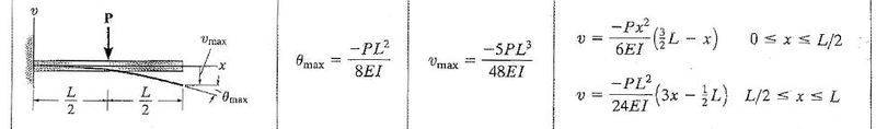

Now to find the deflection at C (see capture2), can I just apply: vmax=(5×RB×(2L)3)/(48EI)
Thanks

This looks like a homework type question and sorry but you are certainly on the wrong track with your current thinking.
One of the reactions at the root of a cantilever (point A) is a fixing moment.
How does this affect your equation
Consider point B. There are two properties/quantities that are zero at B. Have you heard of the slope-deflection equations?
But why do you think the moment at A is zero?
ahh... bugger, I must of forgot moment at A, sorry.
so it should be ƩMat A=0=M-P2L+RBL → RB=(M+2PL)/L
Does it mean that if I was to take the moment around point B, it would be ƩMat B=0=-PL+RAL → RA=P ??
Yes you can use superposition or double integration (with Macaulay brackets) or area-moment or slope-deflection.
However you must apply all the loads correctly.
So the beam tries to act like a see-saw about B.
This implies that it A tries to rise so there is a downward vertical reaction at A.
Additionally there is a moment at A.
Since there is also a vertical reation at B the beam is redundant.
So you have to use more than just the equations of equilibrium.

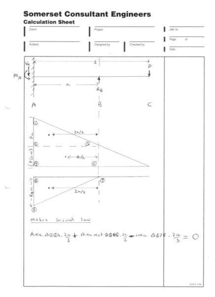

I am continuing with superposition since you mentioned it. Further it is a good idea to understand how to derive the formulae since actual situations or problems may not match your formulae exactly.
OK so I have done the opposite of superposition by decomposing the cantilever loadings in the sketch.
I have drawn the BM diagrams for P alone and RB alone.
You should check you can do these.
Now we can use Mohr's second theorem of the area moment method to derive a formula for RB thus.
For any two points Z and W on the beam, the deflection of Z relative to W is given by 1/EI times the first moment of area of the BM diagram between Z and W about Z.
Now since the deflection at A = the deflection at B = 0 we can say the deflection of B relative to A = 0.
So if we take moments of the areas of the BM diagram between A and B, about B and equate to zero we get,
an equation between L, a, P and RB that we can solve for RB
I have indicated sufficient dimensions and the distances of the centroids of the areas on the sketch.
Use these to calculate a formula for RB and post it.
[tex]R_B = P(a+ \frac{3}{2} (L-a))[/tex]
So then this goes into the equation to find δ at C
Yes I agree with that expression for RB.
