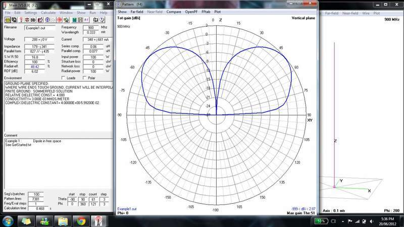

How can you find the resonant frequency of an antenna whether it is a rod shape or an irregular shape or a sphere? I understand they have a capacitive reactance and you may need an inductive load but can someone explain it all in detail and include which formulas to use. I have a radio antenna but I curious to know what frequencies it resonates at.

Unless you are talking about the simplest of antennas, like a dipole, there will not be formulas. You will either have to measure or model. A popular tool for modeling antennas is NEC2. It is free and fairly easy to learn. I'm assuming you are talking about a receiving antenna?
Okay I downloaded the program and went through the tutorial. I got some results but I'm not sure how to interpret the graph that is generated.
Good for you!
Which graph are you studying? Maybe you could attach the NEC2 source file?
Ok long story short, I couldn't start a thread so I made a second account and it just got banned so I'm back to my original account. I attached a screen shot of my results. To be honest I'm not sure how to interpret any of it. I chose 900Mhz because that was in the tutorial. I had to specify frequency and height and radius of the antenna wire/rod but I was under the impression that I could pick a height radius and receive information regarding what the resonant frequency of the rod would be.

First, your antenna only has one wire segment. This will not be very useful.
Your best bet for getting up to speed on NEC2 is to open one of the examples under the \4nec2\models subdirectory. Look at their source code and play around with the simulator to get a feel for it.
You can tell a bit about that antenna from the information given.
That diagram shows a slice of the antenna radiation pattern and since the antenna is symmetrical about the vertical axis, you can mentally rotate it to get something like the top half of a donut.
This tells you the antenna works by radiating most of its power horizontally or up at low angles, but it radiates very little straight up.
The input impedance is 179 - j341. For resonance, the j number should be zero.
In this case, the antenna is being operated below its resonant frequency. You can tell this by the negative sign.
So, either the antenna should be longer or the frequency should be higher.
You can calculate the resonant frequency of this type of antenna with the formula:
Length (in feet) = 234 / Frequency.
So a 900 MHz quarter wave antenna should have a length of 234 / 900 or 0.26 feet or 3.12 inches.
A dipole is about a half wavelength long. A wavelength at 900 MHz is 300 / 900 or 0.333 meters long so a half wavelength is half of this, or 0.166 meters or 6.56 inches.
The "300" in the above formula comes from the speed of light.
A formula for half wave dipole is Length (in feet) = 492 / frequency in MHz
So a dipole at 900 MHz would be 492 /900 = 0.546 feet long or 6.56 inches long.

Wow, thanks a lot. Everything makes a lot more sense now. I just have a few questions. How did you know to look for the j value of the impedance and not the current or the parallel form? And also, will voltage j value always be 0?
Also, the formulas for half wave dipole and quarter wave dipole, are the values "492" and "234" respectively constants?

The impedance is normally always given in the series form and Eznec does not even give the parallel form.
You adjust the frequency of the input signal until the impedance is as close to being unreactive as you can get. So the J factor becomes close to zero. It changes from negative to positive as you go through resonance if you are increasing the frequency.
