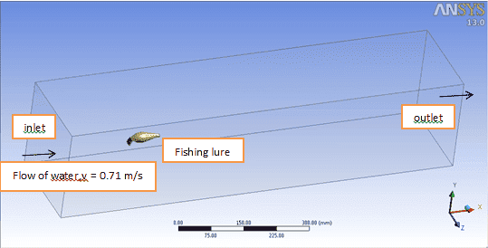

Hello guys, I am here and really need your help.
In the figure below, the water flow from inlet and then out at outlet with velocity, v = 0.71 m/s. The objective is to calculate find the drag force and lift force act on fishing lure. I have done Ansys Fluent analysis but I need to validate the result from Ansys with calculation analysis. I really stuck about how the way to calculate this. I hope you guys can help me to show the way to calculate.
Here is the result executed from Ansys CFD. In the Ansys, I use pressure based mode.
Result from CFD Ansys:
Coefficient of Drag, Cd = 0.02
Coefficient of Lift, Cl = -0.0068
For x-component (Drag Force)
Pressure Drag = 0.03239 N
Coefficient of Pressure, Cp = 0.013
Viscous Drag = 0.01334 N
Coeeficient of Friction, Cf = 0.0059
Total Drag = 0.04574
For y-component (lift Force)
Pressure Drag = -0.016
Coefficient of Pressure, Cp = -0.0073
Viscous Drag = 0.0012
Coeeficient of Friction, Cf = 0.0005
Total Lift = -0.015
The picture below is clearly show the situation:
Given data :
Data of Fluid (Water):
Density of water = 998.2 kg/m^3
Viscosity = 0.001003 kg/m-s
Velocity, v = 0.71
Boundary Condition Data:
Length of X = 0.97676 m
Length of Y =0. 22656 m
Length of Z = 0.225 m
Volume of Water = 0.049774 m^3
Surface Area = 0.98861 m^2
Fishing Lure Data
Mass of Fishing Lure, m : 0.01874 kg
Volume of Fishing Lure, V : 0.000018196 m^3
Surface Area (Wetted Area), A = 0.0050176 m^2
Fishing Lure Body Length, L=0.095 m
The equation that i used to calculated this is F=ma=Drag but the percentage error is very large so that the validation is not acceptable. Now i am very stuck because i am confusing whether to put mass in equation F=ma which is mass of fishing lure or mass of water?
pressure drag + friction drag = drag force
I think the equation above can help me but since i am very slow in my class :)..
My problem is also
1)i do not know how to find pressure drag
2)if i want to find lift force, what equation i want to use?
I really need you guys to help me in anyway to explain me in how the exactly i must do to calculate this problem.

You haen't given enough geometrical data on the lure. Lures have odd shapes, including usually a foil shape (unequal top and bottom surface lengths) to give lift like an aeroplane wing. And then there's the shape of the cross-section the water sees.
Except for standard shapes, drag data is usually empirically derived.

I mean in Ansys, i just used all the surface area as wetted area and not cross-section. The lure is also have lip on front of mouth portion..but honestly i also confusing about the Area that i must use. can you correct me if i am wrong??

That should be drag = m(g-a) if a is acceleration measured vertically in the water.
Lift Force
Lift=W - Fb
Where Fb is (spesific weight)(volume of fishing lure)
= (0.01874kg)(9.81) - (9.789)(0.000018196m^3)
= 0.00568 N
I make it
L = W - B where
W = .01874*9.81 = 0.1838 N = weight
B = 998.2*1.8196e-5 = 0.01816 N = buoyancy force
So L = .1838 N - .0182 N = 0.1656 N = lift force
Your mistake here appears to be in both terms of your Fb equation, and it's very large.
Hopefully that rather larger error, when corrected, will approximate your Ansys simulation. I'm not familiar with Ansys.

You are absolutely right. I forgot the g term = 9.81 in my expression for B. So actually
B = 998.2*1.8196e-5*9.81 = 0.1781 N
and L = W - B = 0.1838 - 0.1781 = 0.00565 N
So there is very little L, in other words, in the absence of water velocity the lure would barely sink.
But L = W - B is correct. The thing is that L is a function of your 14 degree angle coupled with the velocity of the water stream.
Fcos14 can't be right. If the angle = 0 deg. there would be no lift, and drag would be due solely to the lure's cross-section facing the stream. As the angle increases you get more lift and more drag. Above 45 deg. you would get still more drag but less lift. At 90 deg. you would get max. drag but zero lift.
