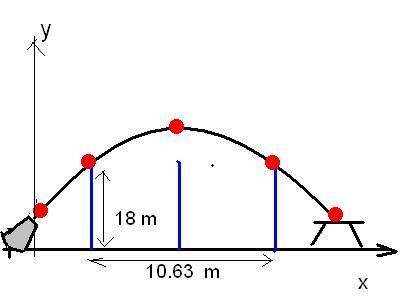

a human cannonball in 1940 soared over three ferris wheels, each 18 meters high covering a horizontal distance of 10.63 meters. Assuming that the point of projection is 2.50 meters above the ground and that he landed safely on a net placed at the same level, find his initial velocity. Assuming that he missed the net and landed on the ground, with what velocity will he strike the ground?

Is a drawing included? The orientation and position of the wheels will be important. If no drawing is included you will need to start the problem making an assumption about where the wheels are.
You can find the velocity for maximum range, the distance between the wheels.
For maximum range the angle at above first wheel is 45°.

Read about "projectile motion". The man moves both in horizontal and vertical direction. There is an equation for the x and y coordinates of the trajectory.
The projectile has to fly over the three ferris wheels, 18 m high and with distance 10.63 m between the first and last ones. The man had to be at least 18 m high above the ground at the place both of the first and last wheels.
Make a drawing to show the launch place, the wheels and the trajectory of the human cannonball.
You certainly learned that you get the maximum distance if you launch a projectile at 45 degrees. The human projectile certainly used that launch angle.
so what is my initial veloctiy if my angle is 45 degress?
You have to find out both the initial velocity and the distance of launch place from the first wheel.
I attached a figure to my previous post, look at it.
What is the equation between the x and y coordinates of the projectile?
