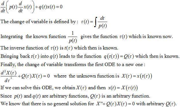

Is there a general solution to
[tex]\frac{d}{dt}\left[p(t)\frac{dx(t)}{dt}\right] + q(t)x(t) = 0[/tex]
for [itex]x(t)[/itex] when [itex]p(t)[/itex] and [itex]q(t)[/itex] are arbitrary functions? Better yet, does this question have a name, or some identifier, that I could look in to? It might appear more familiar written as
[tex]\left[p(t)x^\prime\right]^\prime + q(t)x = 0[/tex]

No, there is no genertal solution

Look up Sturm-Liouville problems or equations.
I think that's just a ODE with non constant coeffecients, since expanding yields
P(t)x''+P'(t)x'+q(t)x=0
You may be able to solve this with power series if P and q fit them.
Non linear differential equations rarely have closed form solutions.
But that's okay, we have computers
Of course, when I say "There is no general solution", I mean "No general analytical solution espressed on a closed form".
Obviously, in some particular cases, with some particular forms of functions p(t) and q(t), the solutions might be known on closed form, and/or be expressed as infinite series.
Even more generally the solutions can be accurately approached thanks to numerical methods.
