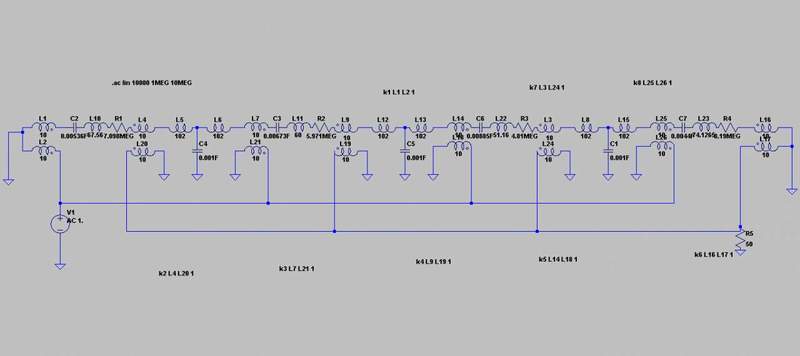

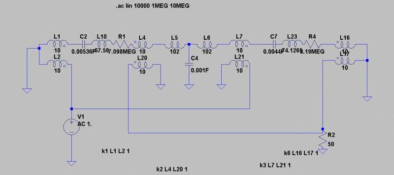

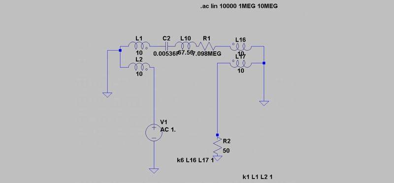

I have to find the transfer function of the complete circuit I send.For this, I divided the all circuit into small pieces.I tried to write the function for the smallest one,and then I realized that all circuit is not a series circuit.By the way, Vac source our input, and output is in front the R2.For this reason,I didnt add R2 into transfer function ? Am I right or should I add it ? Also how can I find the transfer function for the second and the complete circuit ? Can you give me an idea ?

Yikes, that last circuit is involved!
For the first circuit, yes you need to include R2 in the calculation, since it loads the rest of the circuit. Are you told to assume the coupling coefficient of the transformers is 1?
Thanks for your reply.Yes I assume the coupling coefficient of the transformers 1:1Actually I am confused for the grounds.How can I think them ?

Doing a circuit like your #3, or even #2, by hand is next to impossible. Only possibility I see is application of two-terminal network theory (ABCD parameters etc.) but even there the mutual inductances seem to complicate the situation. Also, who knows, maybe constant-k or m-derived theory - I'm not conversant with those.
