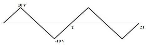

Plot the waveforms for capacitor voltage VC, output voltage Vo, and diode voltage Vd given that Vs is a 20 Vpp triangle wave with period T. Use CVD model with diode VON = 0.7 V.

From my basic understanding of a clamper, I can see that the output is offset by +2 V. Thus Vo begins at +2v, Vc begins at -2V, and the diode voltage begins at 0V and heads towards -10V (off, reverse bias).
However, I can't manage to show this analytically.
KVL around the left side gives:
Vs - Vc + Vd - 2V = 0
At the same time, I know that Vo + Vd - 2 = 0.
I can't really solve anything with just these two equations though.
I can say that Vs - Vc = Vo, but these equations just take me in circles.
Again, I understand that Vo starts at 2V and rises in step with Vs. With that said, Vo = 12 V at when Vs reaches its first 10V peak. At T/2 when the input becomes negative, the diode turns on and the capacitor can start charging. With the diode on, output Vo is clamped to 2V - 0.7V = 1.3V. The 0.7V is the diode drop from the CVD model.
It stays on until 3T/4. By that point, the capacitor has charged to -11.3V. From 3T/4 onwards, diode remains off. Capacitor has no discharge path and remains at -11.3V. At the second 10V peak, Vo is 21.3V.
I just don't know how to show ANY of that with work, which doesn't earn me any points when I have to analyze this on a test.

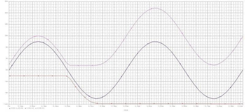

Umm, I was hinting that you should post a graph of v₀(t) over multiple cycles. http://imageshack.us/a/img854/9793/tazm.gif This might allow us to cut to the chase with the explanation.

Not exactly a triangle wave, but it still follows the same general shape. Top/pink is Vo, middle/purple is Vs, bottom/red is Vc.

Are those waveforms close to what you expected to find? Can you explain what they show, and some of their features?
This is a clamper circuit.When the input is at its negative peak,the diode is on and the capacitor is charged opposite to what is shown in the circuit.The capacitor is charged to V=20+2-0.7=21.3V.
Now when the input is at its positive peak,the diode is off and the capacitor stays at the same charged voltage.
The output in first case is (2-0.7)V=1.3V.Voltage across diode is 0.7V
The output in second case is 21.3+10=31.3V.Across diode is also 31.3V since open circuit.
The output is never negative.
