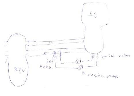

Once again reading reports of PWR main coolant pump seal issues, my mind started to wander.. Is there some obvious reason, why jet pumps are not used as PWR main coolant pumps? This would eliminate the non-isolable leak issue and enable a more flexible pump arrangement.

I was thinking of putting the jet pumps in the PWR cold legs, not in the RPV. That way the leakage point would always be above top of active fuel. The solution to the cooling pump seal failure issue would come from the ability to put each recirculation pump behind isolation valves, which is usually not possible with conventional MCPs due to the large-diameter pipes.
You don't get much benefit as you now increase the piping spectrum you need to deal with.
Additionally, and this is bwr specific knowledge, anyone who has been at a plant that isolated a recirc pump online can tell you it's a bad idea. The thermal transient is very likely to damage the valve, and it also precludes restarting the loop with the unit hot. You also lose any natural circulation you could get (but it prevent freewheeling the pump).

Attached is a sketch of what I was thinking about. The idea is not to replicate the exact BWR application, but to use the jet pump principle to reduce the pipe size (enabling isolation valves) and to make it possible to use two smaller pumps per loop instead of one huge.

I don't know anything about jet pumps but rmattilla's sketch seems like a lot of additional complication compared to the existing RCPs. More parts, more pipes to fail, etc.?
