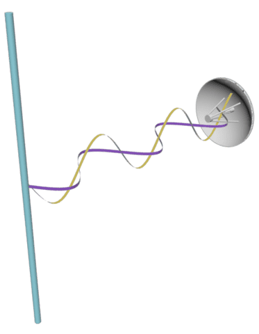

When the electromagnetic wave propagates in air and it meets the object with the size less than the wavelength then this wave simply pass around this object and continues its way as if this object does not exist at all.
Now imagine such situation. The antenna emit the radio waves with the wavelength of let’s say 1 meter and it meet the metallic cylinder with the height/length of 100 meters but width/diameter of 0.1 meter. What will happen? One geometric parameter (cylinder’s length) is more than wavelength, but the second (width) is less, will the radio wave pass around this cylinder or will it reflect from cylinder? :rolleyes:

The effect of this cylinder on a passing wave will depend upon the polarisation. If the E field is at right angles to the axis of the cylinder, there will be very little effect but if the polarisation (E Field) is parallel with the wave the scattering can be significant. The amount of the scattered power (and, hence the effect on the incident wave front) will depend on the actual length of the cylinder in wavelengths.
A conductor of any size will have some effect on an incident wave so there will always some degree of diffraction - certainly a half wavelength wire behaves like a plate with cross section of about 1/2 by 1/2 wavelengths when the polarisation is parallel to the wire.
So, if the E field is parallel to cylinder then this cylinder will be able to scatter that wave and hence some detector (radio receiver or something like this) will be able to “see” the object/cylinder, right? Did I understand everything correctly? :rolleyes:
