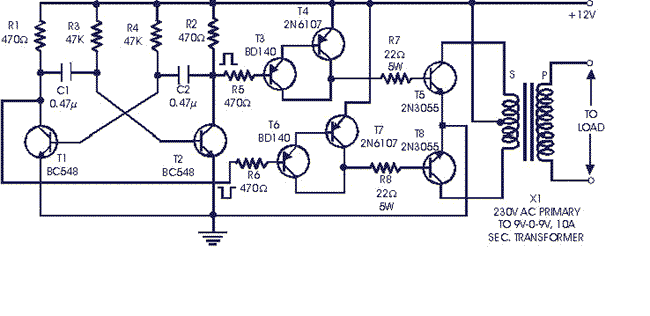

now lift your DC voltage and current supply up a bit and you start to get something more useful like this example...
just a quick explanation...
T1 and T2 are part of a multibivrator oscillator circuit. They are connected respectively to 2 pair of driver transistors, T3,4 and T6,7. Those pairs of driver transistors control the 2 x 2N3055 power transistors, T5,8.
The 12VDC supply is connected to the collectors of T5,8 via each half of the transformer windings. T5 and T8 are switched on and off alternately by the oscillator, this produces a low voltage square wave oscillation in the secondary of the transformer of roughly 18V peak to peak resulting in a ~ 220V output in the primary of the transformer.
This is a square wave inverter and for many applications its quite useable. However some equip requires a clean or at least relatively clean Sinewave 220 (110)VAC.
I just present this to give you a bit of an idea of what is involved in a basic DC to AC inverter :)
