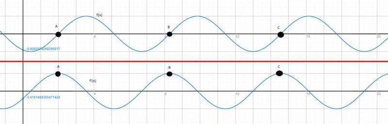

[tex]x(t)=Acos(ωt+ϕ)\\v(t)=-ωAsin(ωt+ϕ)[/tex]
I think my physics professor said in one of the lectures that: after setting up your position function by finding amplitude, angular speed, and solving for ϕ by setting t=0 and using the x(0) value given in the question, you need to to set t=0 in the velocity function and use the v(0) value to make sure your ϕ value is correct.
I'm confused. Why is this necessary?
If you have some x value you can cross it on the way up or on the way down, this is why you need to check v(0)

Attached is a graph of f(x) and f'(x). When you do the inverse sign you get a value plus [itex]2πn[/itex] where n is an integer.
For example:
[tex]sin(x)=1\\<br /> x={π\over 2}+2πn[/tex]
Each x value would be 1 period apart. Therefore, as you can see in the diagram, points A, B, and C are all 1 period apart, and f'(A)=f'(B)=f'(C).

tahayassen said:
Okay, this still doesn't make sense to me.
For example:
If you look at the top graph, you'll see that, inbetween A and B, there are two points where the plotted curve crosses any value on the y axis.
Mathematically, there are generally two solutions of
[tex]sin(x)=y[/tex]
in the range 0 [itex]\leq[/itex] y < 2[itex]\pi[/itex].
Your example of
[tex]sin(x)=1[/tex] is a special case because it's a turning point.
In terms of the physics:
The pendulum returns to its initial position twice within the period.
The difference is that it is now moving in the opposite direction, so the velocity has changed sign.
So we need an initial condition for the velocity as well as the position in order to uniquely define [itex]\phi[/itex]
