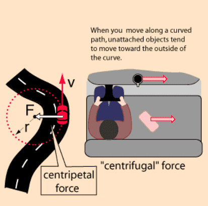

Centripetal and centrifugal forces
I couldn't find the term centrifugal force in any of my physics books, hence I checked out PF. Can you provide some links (non Wikipedia) about centrifugal force .
Here is what I understand about this force :
I think this term was self created by humans for their own better understanding of the "motion" of objects in circular orbit.
We, the modern physicists would call it nothing but a consequence of the fact that any object undergoing circular motion tends to move in a straight line (tangential to its path) . So it can be thought of as "inertia" , but I would stick to my claim that this force is non existent.
In your diagram of the car in a turn, there is a Newton third law pair of forces, an inwards centripetal force exerted by the road onto the car, and an equal in magnitude but opposing outwards reaction force that the car applies to the road. That outwards force is real, the issue for some people is using the term "reactive centrifugal force" to describe that outwards force that the car exerts to the road.
A more simple example might serve to make this clear:
consider a train that is accelerating with acceleration a. You are on this train and you drop a ball. The only force due to a physical interaction acting on the ball is that of gravity which is due to the ball's interaction with the Earth.
However, you see the ball accelerating away from you with the same magnitude of acceleration as that of the acceleration of the train. Thus if we consider the acceleration of your reference frame (keep in mind that since you're measuring the motion of the ball with your position as the origin, you are at rest in your reference frame) as the source of a force on the ball, it applies a force of magnitude ma, where m is the mass of the ball. This force isn't due to any physical interaction that you can observe, that's why we call it fictitious. I agree that calling it fictitious is confusing and that inertial is less confusing and also an apt name in that the magnitude of the force is proportional to the mass of the object
A similar thing happens when you're in a rotating reference frame (for instance say someone does this while on a merry go round) except that now this fictitious force is directed outwards from the center of the merry go round. This type of fictious force due to being on an accelerated (or noninertial reference frame) is called centrifugal.
A centripetal force is the net force in the radial direction due to real forces and is generally talked about in an inertial or non-accelerated reference frame. Hope that clears it up a bit
If you think about it, the reactive force is just the force exerted by the car on to the road, but this does not relate (even remotely) to the diagram .
The diagram shows that there "seems" to be a force acting on the objects which tend to move outward (in the opposite direction of centripetal force). So the force you talked about is the force exerted by the car on the road and not the objects.
Think about this :
You are sitting on the backseat of a car, and this car is turning around a corner at high speed. You would have noticed yourself moving outwards (right ?) until you reach the door of the car which then would provide the appropriate centripetal force to your body.
Notice that this situation is based on the fact that friction could not provide the centripetal force. Notice also that at all times you would be "FEELING" some outward push , (again , which in my opinion is just inertia but not centrifugal force)
Am I right in the above mentioned aspect ?
You switch frames back and forth and confuse the issue. Stick to an inertial frame, and there are no inertial forces. Stick to a non-inertial frame, and you always have inertial forces which act just like interaction forces (except Newtons 3rd).
Both is correct and leads to the same quantitative predictions, which is all that matters in physics. Musings about "realness of forces" is philosophy.
