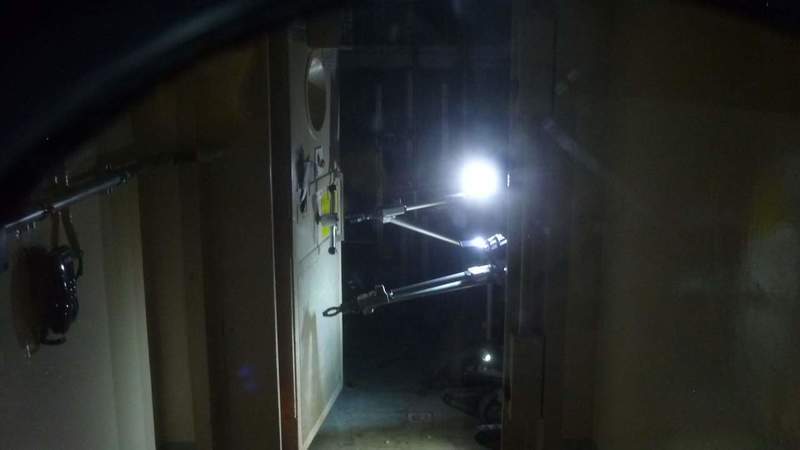

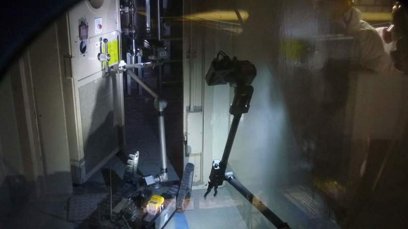

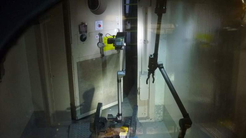

Packbot(s) entered into reactor buildings 1 & 3, after opening some of the doors connecting with the turbine buildings. Measurement results are expected to be released on April 18th or later : http://www.jiji.com/jc/c?g=soc_30&k=2011041700293

The robots entered the plant's number 3 reactor building and were due to take radiation and temperature readings. They are equipped with video cameras that can provide a live feed to operators
Wow, finally - now that is cool! How about a live feed? Somehow I don't think TEPCO will be as forthcoming as BP in the Gulf oil spill (well, actually BP was ordered to provide the ROV feeds if I recall..)
