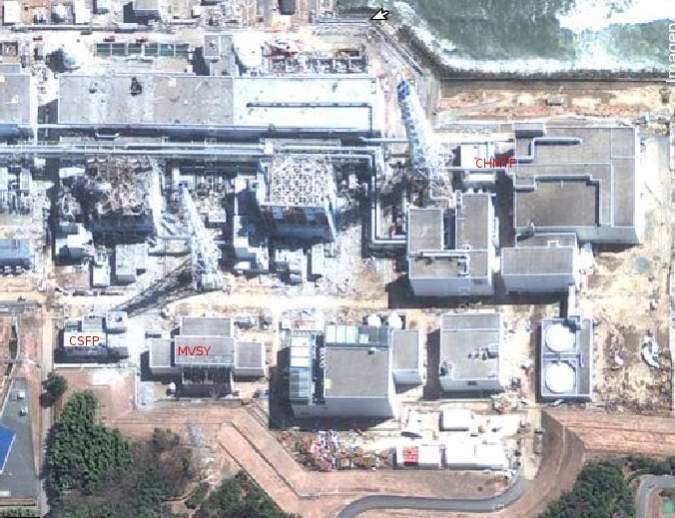

Since April 1st Tepco has conducted sprayings to bind radioactive dust in certain problem areas. The efforts have been concentrated on the mountainsides behind the two buildings 'across the street' from unit 3 (the Common Spent Fuel Pool (CSFP) and the Medium Voltage Switchyard (MSV) respectively), and to the area around the Central Radwaste Treatment Facility (CHWTF), situated to the south of unit 4. (see attached annotated map)
21 April 2011: 1300 m² mountain side at the CSFP
21 April 2011: 5100 m² mountainside at MVS
20 April 2011: 1900 m² around the CHWTF
18 April 2011: 1200 m² at the CHWTF
17 April 2011: ? m² at the CHWTF
16 April 2011: 1800 m² mountainside at the CSFP
15 April 2011: 1900 m² mountainside at the CSFP
13 April 2011: 1600 m² mountainside at the CSFP
11 April 2011: 1200 m² mountainside at the CSFP
8 April 2011: 680 m² mountainside at the CSFP
5 April 2011: 550 m² east and south mountainside at the CSFP
1 April 2011: 500 m² mountainside at the CSFP
