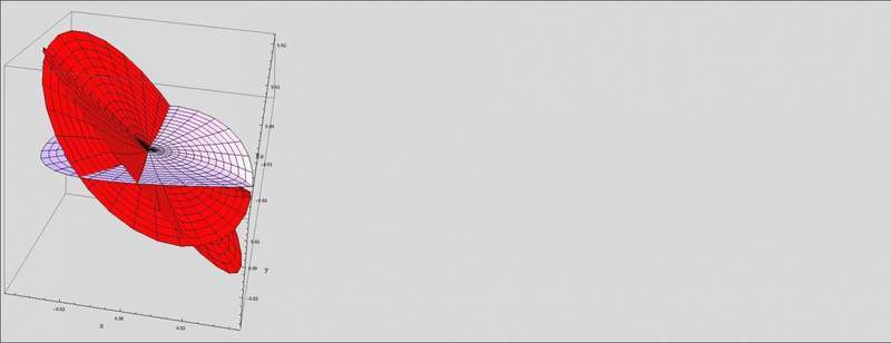

Hi, given the algebraic function:
[tex]f(z,w)=a_n(z)w^n+a_{n-1}(z)w^{n-1}+\cdots+a_0(z)=0[/tex]
how can I determine the geometry of it's underlying Riemann surfaces? For example, here's a contrived example:
[tex]f(z,w)=(w-1)(w-2)^2(w-3)^3-z=0[/tex]
That one has a single sheet manifold, a double-sheet and a triple-sheet manifold as best as I can describe it and illustrated by the real part of w(z) shown below and will of course give rise to the expansion
[tex]f(z,w)=\left(w-g(z)\right)\left(w-h(z^{1/2})\right)\left(w-u(z^{1/3})\right)=0[/tex]
or:
[tex]f(z,w)=\left(w-\text{red}\right)\left(w-\text{gold}\right)\left(w-\text{purple}\right)=0[/tex]
which is my interest in this problem and I've not split up the factoring into separate single-valued terms, i.e., gold and purple are multi-valued. However, is there a method to determine this manifold geometry for the general case just by an analysis of the function [itex]f(z,w)[/itex]? I know the Newton Polygon procedure can determine this indirectly but I believe that has limitations and will not work for certain functions. I was wondering is there is another way. That is, given [itex]f(z,w)[/itex], is there some (exact) algebraic operation on it I can perform and obtain the sheet orders which in the contrived case above would be 1,2, and 3?
Thanks,

That's ok Mathwonk. I figured you are busy. Thanks for the Walker reference and the other references above. They're helpful. Also, I'm afraid I used an abuse of notation above. That's really three factors:
[tex]f(z,w)=\left(w-g(z)\right)\left(w-h(\epsilon_1z^{1/2})\right)\left(w-h(\epsilon_2 z^{1/2})\right)[/tex]
however the two factors of [itex]h(z^{1/2})[/itex] come from the same 2-valued manifold, just different single-valued determinations of it. Just thought my condenced notation was cleaner-looking.
And the expansion comes from Newton-Puiseux's Theorem:
The quotient field [itex]\mathbb{C}((z^*))[/itex] of convergent fractional power series (which I assume includes all analytic functions) is algebraically closed so for [itex]f(z,w)=a_n(z)w^n+\cdots+a_0(z)[/itex], with [itex]a_i(z)\in \mathbb{C}((z^*))[/itex], we have
[tex]f(z,w)=\prod_{i=1}^n \left(w-g_i(z^{1/k_i})\right)[/tex]
with [itex]g_i(z^{1/k_i})\in\mathbb{C}((z^*))[/itex]. One reason I knew the expansion was in terms of [itex]g(z)[/itex] and [itex]h(z^{1/2})[/itex], is because I drew it:
(Not entirely sure I'm quoting that theorem precisely. This is all very new to me.)
