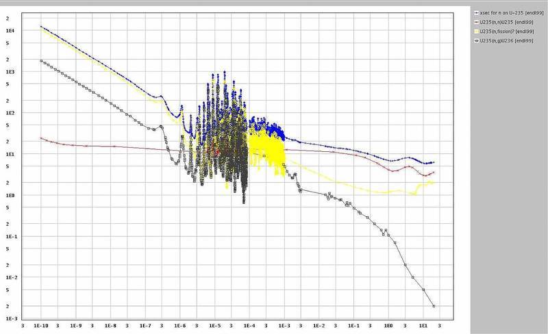

Andrew and Astronuc,
Here's a plot of the total cross-section, along with elastic scatter, fission, and (n,gamma).
As can be seen; for low energy neutrons, fission is the dominant decay mode. However,
for high energy neutrons, above the resonace region; fission loses out to elastic scatter
by a wide marging.

I should have qualified my comment which refers to thermal neutrons. In the epithermal and higher energies, as Morbius indicated, the fission cross-section, i.e. the probability of fission, decreases in favor of scattering.
