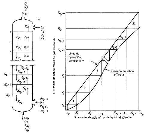

Firstly, If you say that you want to draw an equilibrium curve.
The expresion y*=Hx, it's not a curve. It is a line. Usually if we work with a not concentrate solutions we can use the expresión because the equilibrium curve is like a line, and if you want to estimate the stages with McAbe-Thiele for the absorption it will be easy.
Then, if the solution is high concentrated you have to use a table with the sulfuric acid-water data, because the equilibrium will be a curve. In this case, if you want to aply McAbe-Thiele method you can work with a "soluto free basis" to transform your curve in a line.
The values you need are the equilibrium values for the Sulfuric acid - water system.

If the operation line is also the equilibrium line, your tower have no stages and this never happens.
( To explain that clearly you can see this graphic. The stages are calculated always between the two lines )
If you think about you have said, you'll see that you have calculated the operation line to specific concentration in the top, usuallý defined by performance. If you change the performance of the tower, the points (x1,Y1) (x2,Y2) will be diferent , and the operation line too.
Think I understand but that graph shows a straight line for the operating line which I have already, and a curve for the equilibrium line, I know how to extrapolate data from the two lines but cannot draw an equilibrium line I think. I constructed my operating line using (y1,x1) and (y2,x2) or should that be my operating line, if so how do I construct the other line.
