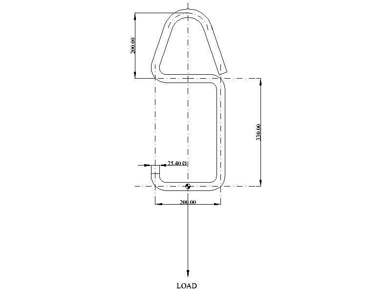

Hi,
Its been quite a while since the last time that I had to solve a classic statics load problem (about 20 years ago).
Here is my problem:
I have a simple "C" type hook (please refer to attachment "Gancho.jpg") made of 25.4 (1 inch) diameter commercial steel (for example cold rolled steel)
And I need to know which would be the maximum load that the hook can withstand.
Thank you in advance.

Maybe I am late with this response, but I learned an analytical technique last year for finding the stresses in curved members.
Its called the "Winkler-Bach Method". It is based on the assumption that transverse planar sections in the curved parts of the member are do not deform. "plane sections remain plane".
If you still want to know about it let me know and I will show a quick analysis for one of the curved parts. With that, you should be able to do it for the rest of the curved parts.
Heres what you need to know first:
1) What is the radius of curvature of each of the bends. The drawing attached does not indicate this. THIS TECHNIQUE IS WORTHWHILE ONLY IF THE CURVATURE OF THE MEMBER IS COMPARABLE TO ITS CROSS-SECTIONAL DIAMETER
2) What is the maximum tensile strength the steel and safety factor in the design.
3) What failure criteria need to be considered for the material. I would probably put the maximum shear stress in the member at half the tensile strength of the material if cracks are not a concern.
4) Perform a static analysis to determine the forces and moments where the curved parts are tangent to the "straight" members. The forces and moments can be related to the applied load on the hook.
5) use My/I=-Ey/(r0-y)*r0*(1/r-1/r0)
M- moment acting on curved segment
Use principles from statics (Newtons 2nd law) to relate the applied load to 'M'
I- moment of inertia = pi*(1 inch)^4/32
y=d/2=0.5"
r0- distance from centroid of curved member to the location where the stress is to be determined
r- distance from center of curvature to location where stress is to be determined
I use this a lot with FEA to check the maximum stresses in a model (FEA results distribute stresses accurately, but the maximum values are often off by at least 10%, and usually 15% in my experience.)
If all you want to do is find the static loads and moments, you need to specify the location. My knowledge leads me to believe that the most stress will occur in one of the curved segments.

"THIS TECHNIQUE IS WORTHWHILE ONLY IF THE CURVATURE OF THE MEMBER IS COMPARABLE TO ITS CROSS-SECTIONAL DIAMETER..."
Ok..all radii involved are 20 mm (the inner curve of the material is 20 mm). So, I think it complies with this criterion...right?

Yes. it does. However, the bend at the top of the hook appears top have a significantly larger bend radius than the other ones. Are you sure they are all the same? If the drawing you provided has a uniform scale, they definitely are not all the same.
Confirm this, and we can continue.
once you know the bend radii you should first use geometry to find the length of the straight segments of the piece.

Overall, this is not a very good design for a hook. The corners act as stress concentrators that subject several parts of the hook to large bending stresses. Additionally, the round cross-sectional geometry gives large stresses at the edges of the material.
I would recommend buying a hook from McMaster-Carr that suits your lifting requirements, rather than bending one out of 1" rod.

At the top of the hook the bend radius is 50 mm.
Mech Engineer: your recommendation sounds good. The problem is that someone came up with the idea of fabricating this hook as I show it in the sketch, and start using it. So I was asked to work out from a theoretical point what the "safe" maximum load is going to be, and may be to put a sticker on the hook stating something like "Caution - Max. load = ??? kg.

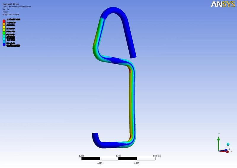

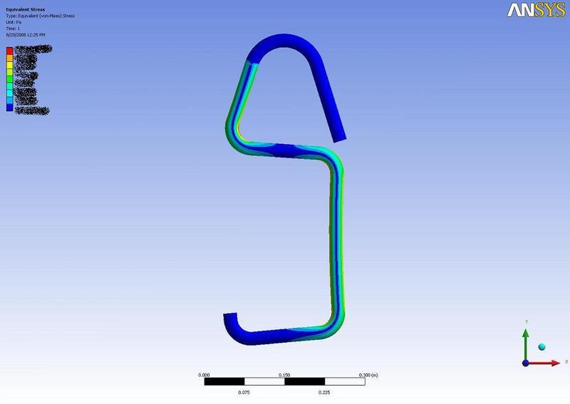

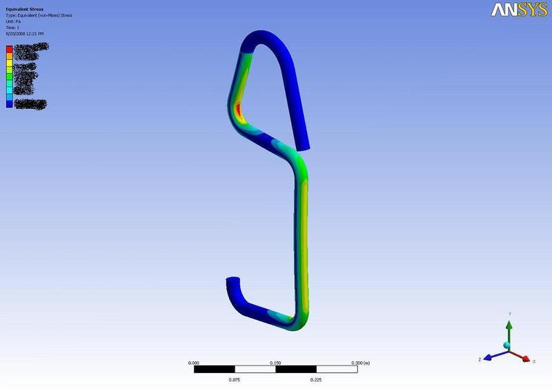

The maximum stresses in the hook occur at the sharp corners, not at the long section you are trying to approximate as a cantilever (I'm not sure calling it a cantilever is a very good approximation anyway).
One way or another, like I said before you CAN'T rate the hook's strength, because you know nothing about the material it is made out of or how the hook has been used in the past. Giving a rating for the hook is a very dangerous prospect because if the hook fails while operating under your "rating" and the accident damages expensive equipment or injures/kills someone, YOU can probably be held responsible for it.
In my opinion, you need to tell your boss you cannot properly rate the hook for the reasons I have specified. Otherwise, you're jumping into a pool of water headfirst without first knowing how deep it is.
I have attached some simple ANSYS model pictures that qualitatively show where the maximum stress occurs in the hook. I have blanked out the numbers in the picture because the hook's exact material properties (which we don't know) will determine the stress.
