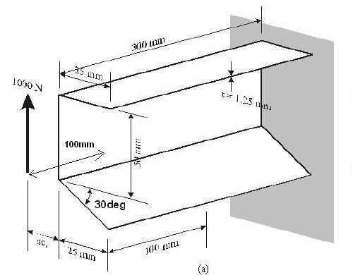

Thanks for ur help, Ok so here's the next question,
C-section beam of 300mm , Sy = 1000N
Finding bending stresses 100mm from the point of load...The force causes compression on top and tension on the bottom hence bottom stresses should be +ve and top stresses -ve.
100mm from the point of load would mean a bending moment of 1000x100 = 100000Nmm in the positive sense about x-axis.
The bending moment caused by Sy in this case is +ve Mx (moment in the x-axis). Am I correct?
I'm getting positive values at the top corners and negative at the bottom corners for bending stress which is clearly wrong!
Regards.

Quote by emRage View Post
Thanks for ur help, Ok so here's the next question,.
uh-uh, can you please start a new thread?
(and can you make it clear where the point of application of the force is?)
Then other members will come in and help …
all this stress and moment is getting a bit out of my depth.
