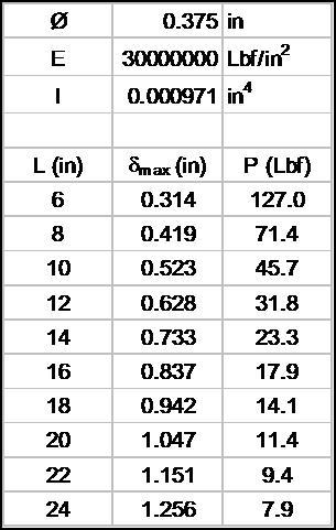

One of the things we need to know is the length of the rod.
Just using very rough cantilever beam equations, here is a quick chart for estimating the required load to deflect the end of the beam the required amount to bring it level with the wall end, i.e. L*Sin(3°).
This assumes a lot. I assumed a steel rod and constant cross section as well as neglecting shear terms as well as angular affects on the load at the end of the rod and, most likely, some large deflection issues with yielding. Hopefully your rod is about 24" long.

Fred, how did you calculate your second moment of area? Yours is almost a factor of 20 lower than what I got (I calculated I = 0.016in^4).

To achieve a 3 degree deflection over the legnth of the bar, it looks to me like your box weighs over 550 pounds. The stresses are high for a normal steel as well, it's likely you're yielding the material near the bend radius at the mounting point for the bar. This is a large deflection beam bending problem, but for a quick approximation the beam bending formulas can at least give you an idea of what you're up against.
EDIT- I see that you say in your orignial post the box only weighs in at 8 pounds. This tells me that the 3 degrees of deflection you are seeing is due to a loose fit in the mount at the wall, NOT due to beam bending. An 8 pound load on the bar you're describing should only deflect it .139" at it's end, or about .7 degrees; on the other hand if the hole the bar is mounted in is .1" larger, that would account for the 3 degrees.
LaTeX Code: I=\\frac{\\pi d^4}{64} I thought I saw a rod of 3/8". Let me go back and double check.

For a circular cross-section:
LaTeX Code: I_{xy}=\\frac{\\pi R^{4}}{4}
EDIT- Gah, that damn factor of 2 and radius vs. diameter! It'll get you every time! I was off by 2^4=16.

Thank you for taking the time to address this. Given the measurements above (and the .1" loose fit), is there a simple equation that would point to the 3 degree adjustment?

What size hole is the bar being mounted in?
1.88in*sin(3deg)=.0983in
