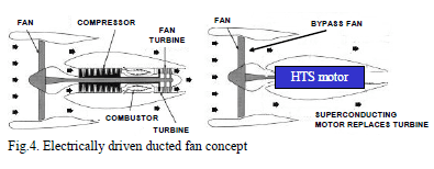

Ducted fan concept:

I do not see what this prize is supposed to do, it's certainly not going to 'start' people thinking about electric. As for your post above, does a 'superconducting motor replaces turbine' exist outside of the imagination?
? That's not my sketch. AFRL built a 3MW motor. It's out of the paper in the link I referenced in the other thread.

I'm looking at that ppt, and I have to ask: why would you use an electric motor to power a ducted fan, and not just use a more efficient propeller???
Sorry I don't follow. What source of power are you suggesting, if not an electric motor? Edit: Perhaps you are asking: why use an electric motor instead of a traditional gas turbine? Electric motor can be >95% efficient, is quiet, as you mentioned above, and can run on electric charge that may have been generated on the ground and stored in the aircraft.

No, i'm saying why would you power a fan, instead of a prop. Larger rotors are more efficient.
Oh. Prop aircraft are more efficient that turbofan jet aircraft? Still? I wouldn't know. This is a contest so speed matters, so my first hunch was to go with the fan. I was guessing something under 200-300 knots would be required to keep the losses to drag down, but I am vaguely aware that the altitude, lift, and air speed couple together in matter (that's beyond me) that complicates the energy efficiency issue.
