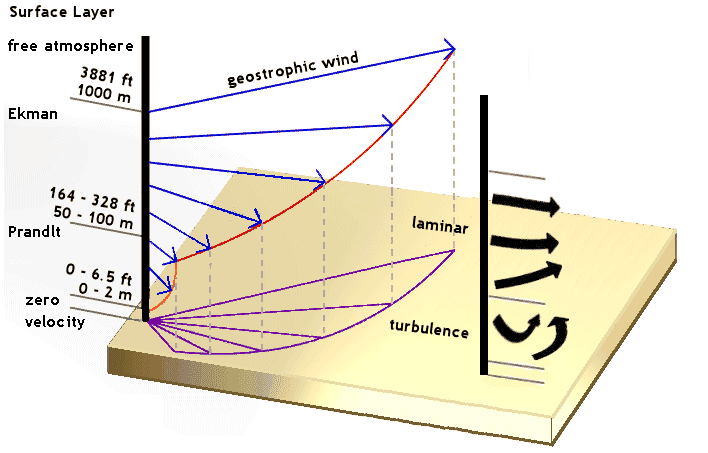

#142
Sep25-10, 11:35 AM
P: 59
One more question on the wind - I found a nice picture on this (see attachment)
Would this mean that a hose with pull from top would actually form more or less such a bent curve ?
