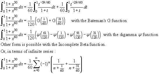

Halen
how would you integrate (1+x^30)/(1+x^60) from 0 to 1?
tried so many ways but in vain..
any help?

Did you try to use the substitution t=x^30 ? This should simplify your integral quite a bit.
Then just do some smart algebra and factorisation.
EDIT: This is wrong. Sorry for the confusion
Hi !
May be this can help you :
