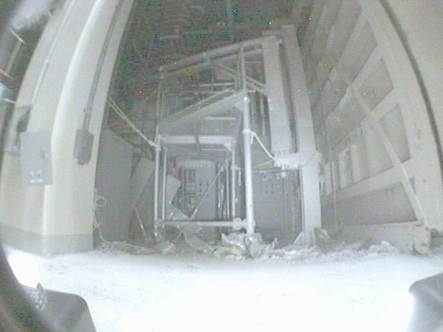

Regarding the Gamma Camera images at http://www.tepco.co.jp/en/news/110311/index-e.html
Does the fact that the Gamma Camera registers significantly on the (broken?) ventilating ducts imply that the electrically powered HVAC fans were actively circulating radioactive material before they lost electric power on 11 March?
Tepco press releases often seem a bit like their plant releases, they do nothing to clear the air.
In this case, are they simply surveying the place, or perhaps looking for a failure point or are they looking to see what equipment can be made serviceable?
If they are looking for a failure point then SGTS ducting outside of primary containment but inside the building would be a good candidate (it's my "favourite" for how hydrogen made it throughout the RB's). The SGTS's projected failure during reactor overpressure "incidents" is what prompted the Direct Torus Vent System retrofit.
However, there are the SGTS ducts, HVAC ducts and others, who knows what the ducting system is in the pictures, who knows why tepco surveyed it and who knows why they showed it to us.
There are lots of docs on the net going into GE Mark 1 BWR "issues" in depth but this one does two of the more likely failures in brief -
Page 4 of this document has a brief section on the Brunswick plant stress test that revealed the BWR Mk1 containment dome lifting off it's seals at 70psi and also the SGTS issue as mentioned above.
The PDF on this page, "May 22, 2011 Dose-measurement points by gamma camera..."
http://www.tepco.co.jp/en/nu/fukushi...s/index-e.html
is this file http://www.tepco.co.jp/en/nu/fukushi...10522_01-e.pdf
The first page shows where the pictures were taken from. It looks like they drove the gamma cam bot in through the vehicle portal ("carry-in gate for large stuff") and took pictures straight ahead, and then turned right 90 deg and took some more. The electrical panel on the column with the door hanging off of it is in both pictures. The second picture, then, is from an area near the SW corner of the building with the camera pointing South, while it seems to be pointing East in the first picture.

Quote by westfield View Post
My second reply to this... I adjusted the levels a little on the second picture (the one to the south) just to enhance the contrast a bit. It's a little more complex up there than I initially thought. There seems to be a jib crane mounted on a vertical pivot that is probably used to load and unload equipment and fuel from vehicles. Other than that, it looks like a rat's nest of pipes and other things.

Concerning the white dots in some pictures in areas with radioactivity: this is a different subject than above but to me this is clearly the effect of the radiations (gamma) on the sensor. This is very well shown in the experiment in the video posted. Some of these dots may be in fact dead pixels from a previous exposure (like in the experiment shown) or pixels reacting to some gamma rays i think.
CCDs are considered more proned to this than CMOS but CMOS are also vulnerable to this. There is a complete thesis available on this subject:
http://www.cse.yorku.ca/visor/pdf/MSc_thesis_Henok.pdf
