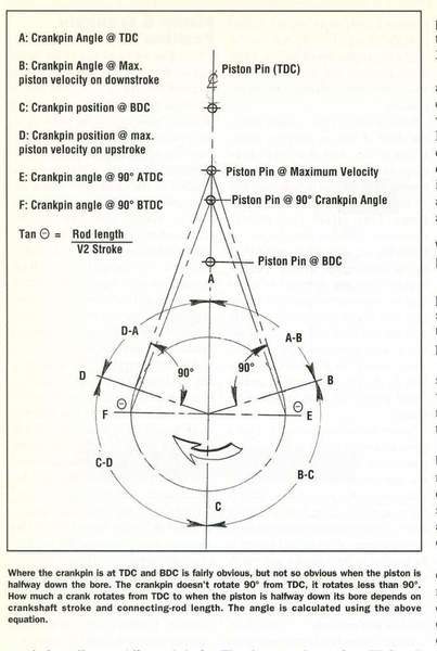

I suggest a review of the mechanics that occur is in order. The crankpin is not 90 degrees from TDC or BDC when the piston is at mid stroke. In fact when the crankpin is at 90 degrees the piston travels more than half stroke from TDC. Because the piston travels farther during the " first " 90 degrees, of crank rotation the piston velocity is higher from TDC to the mid point than it is during the last half of crank rotation.
SEE post gas pressure in internal combustion gasoline engine 22 Nov 09 on this forum
