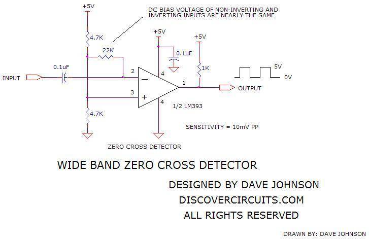

Also, could you post a link explaining the circuits able to detect zero-crossing of waves, and likewise would such circuits work for high frequency waves, or can the period not be faster than the processing speed of the circuit?

A zero-crossing circuit actually produces a square wave, high to low and low to high transitions take place at the zero crossing of the input sine wave or a noisy sine wave. You'll still need some type of microcontroller to read times when the transitions ocurred. You can build the zero-crossing circuit using any simple analog OP-Amp or comparator chip. Highest frequency I have seen such a circuit can handle is 140KHz.
I tried to attach a jpg but doesn't seem to work. OK, it may be working

A single zero cross detection circuit won't give you phase...as has already been stated, phase is relative. Two zero cross detectors and a reference signal will give you phase, though, as the difference in zero crossings. You will need to treat the rising and falling edges differently to handle the full range of possible relative phases.
Another approach to phase measurement is to multiply the input signal with a reference signal, and filter the result. Multiplying two sine waves in phase gives a sine wave of double the frequency, half the amplitude, and an offset that makes all parts of the waveform positive. As the sine waves move toward being 180 degrees out of phase, that offset shifts to make the output waveform entirely negative:
