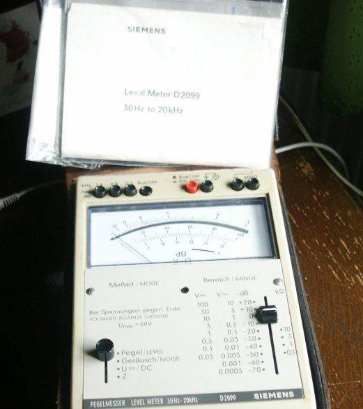

Jan23-12, 04:08 AM   #40
However you would need a 40 tonne artic to carry all the stuff mentioned here, rather than a toolbox.
We seem to be continuing this older thread.
http://physicsforums.com/showthread....t=meter&page=2
One cheap sig gen solution in post#23
Meter solutions in post#5
Attached is a useful older portable audio and telephone test set pic. It incorporates sources, load and metering.
