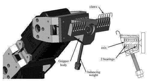

Feb18-12, 07:48 AM   #3
Of course i can!
I mean some kind of the scientific figures which are accurate in details like attached image.
but about your suggestions..... i am for example familiar with Inkscape but i did not find it so effective to generate high quality figures like attached one...... furthermore I should confess that i have not required artistic talent to design them...!!!!!
Feb18-12, 08:07 AM   #4
how can i draw scientific figures for my papers?
or the other example could be.....
Feb18-12, 08:23 AM   #5
Looks like you need some kind of 3D modeler; to start, take a look at Wikipedia and go down to where they list commercial and free software.
The problem is always with the "powerful but simple to use" part....necessarily, as things get more capable, they get more features, etc...so the learning curve seems to keep growing.
I wonder if the free version of SketchUp would be enough for you; take a look at the gallery.
Then, there is Blender; I have heard good things about it, powerful, scriptable, etc...except for an awkward interface?.
Now, if you need something more CAD-like, like in your second picture that include a 3D along a 2D sketch, you need to look into CAD programs...one I have been looking at lately is the up and coming FreeCAD...but that's just because I like free software...if you have money to pay for supported software, you can look into commercial packages, etc.
