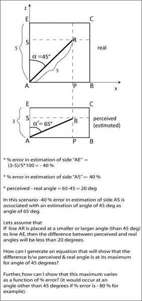

Hi,
I am hoping to generate an equation that will describe a maximum error
in estimation of angles. I would like an advice on the type of
math/methods/devices (e.g., differential equations?) that I could use to solve this.
Here's the problem:
Imagine a square with an oblique line inside the square. Let's say the oblique line touches the left bottom corner of the square. Of interest is the error in estimation of angles between the oblique and the left side of the square. I will refer to it as the angle of an oblique.
By error I mean the difference between the true angle and the estimated angle.
If the length of two parallel sides of a square is misestimated relative to the other two sides, then the angle of an oblique will also be misestimated in a very specific way. Here's the twist: the misestimation of angles will vary depending on the physical angle between an oblique and the left side of a square.
If one of the sides of a square is misestimated by less than 50 %, for example, the maximum error will presumably occur for angles that are about 40 degrees to the left side of the square.
I would like to generate a function that will show (1) when the maximum error should occur (i.e., at which angle of an oblique?), (2) what is the maximum error (e.g., angle is overestimated by 12 degrees; therefore error = +12 degrees). Maximum error will depend on percent error in misestimation of lengths of a square, and the physical angle of an oblique.
I hope this is clear enough. Thank you for your help!

Thank you for your reply, Stephen. This question is about a square that is perceived as a rectangle. For example, an observer may underestimate sides "AE" and "BC" but accurately estimates sides "AB" and "EC." An observer does not assume that all sides of the square have length equal to his estimate for BC.
A line passing through A and hitting side BC will be at a larger angle from side "AE" in a rectangle above than a square. This is because a component of the line parallel to side "AE" will be underestimated by the same amount (in % error) as the side of the square.
As an analogy, consider what happens with a diamond inscribed within a square seen as a rectangle. The diamond will look squashed in the latter. Consequently, the angle between its side and the adjacent side of the square will be overestimated.

Thanks, chiro. I attached a picture which I hope will clarify things.
The angle of interest is angle alpha. Any suggestions will be much appreciated!

PatternSeeker,
You have not clearly described the experiment that collects this data. For example, does the person being tested report "I think angle alpha = 65 degrees"? Or are you deducing the person's opinion about angle alpha from his opinion about other dimensions of the diagram. For example, does the person report "I think AE = 3" or do they report "I think AE = 3/5 of EC?". If the person does not report a perception of the angle, I think calling the 65 degrees a "perceived" angle is misleading.
If you are computing the angle, how are you computing it? My speculation is that you know the actual dimensions of AP and RP. When the subject reports his guess g about distance [itex]\overline{AE}[/itex] , you assume all vertical distances are shrunk by the factor [itex]\frac{g}{\overline{AE}}[/itex]. So you compute the "perceived" angle as
[itex]\alpha' = \arctan ( \frac{ \frac{g}{\overline{AE}}(\overline{RP})}{\overline{AP}})[/itex]. Is that what you do?

I used the term "perceived" for angles that would be estimated by observers. In this example, they would report angle as 65 degrees. Real angles are physical angles. The data I put up on this portal are made-up. I used the formulas such as the one you gave to generate these hypothetical data. % error in perception of length of stimuli is derived from a theory.
Just as a reminder, I would like a suggestion about how to develop an equation that will produce an answer to where the maximum error (perceived - real angles) should occur.
For example, assume that the % error in misestimation of lengths is - 40%. At what real angle between two edges of stimuli should the maximum error in estimated angle occur? I can certainly generate lists of values to figure this out, but I need a formula that will give me a single answer.
I provided more details in the attached picture, and in previous posts.
Thank you for your attention and suggestions about how to clarify this problem. I hope to hear from you again. Any further suggestions will be appreciated.
Can we agree that the problem is:
Given [itex]\lambda > 0[/itex] find angle [itex]\alpha[/itex] that maximizes [itex]f(r) = | \arctan(r) - \arctan( \lambda r) |[/itex] where [itex]r = tan(\alpha)[/itex].

For a "40% underestimate", [itex]\lambda[/itex] would be 0.60. (I try to avoid using the terminology "percent" whenever possible. It often introduces confusion.)
Just glancing at the problem, I think the angle of maximum error is [itex]\arctan( \frac{1}{\sqrt{\lambda}})[/itex], but I must go do something now. I'll look at it closer later.

It's one of those calculus problems where you find extrema of a function by setting its derivative equal to zero and solving for values that make that happen.
For
[itex]f'(r) = \frac{1}{1 + r^2} - \frac{\lambda}{1 + \lambda^2 r^2 }[/itex]
if [itex]\lambda < 1[/itex]
If you're looking for a maximum, you must verify that a given solution of [itex]f'(r) = 0[/itex] produces a maximum instead of a minimum or an inflection point. You also have to check if the endpoints of the range of [itex]r[/itex] are extrema. In this case [itex]r = 0[/itex] is a minimum.
Since angles (in mathematics) are usually measured counterclockwise from a horizontal reference line, I computed the angle that way.

Suppose we have right triangle ABC with hypoteneus AC, let [itex]\alpha = \angle BAC[/itex]. Let [itex]r = \frac{BC}{AB}[/itex]. Then [itex]\alpha = \arctan(r)[/itex]. If [itex]BC[/itex] is multiplied by a factor of [itex]\lambda[/itex] then [itex]r[/itex] is multiplied by a factor of [itex]\lambda[/itex] and [itex]\angle BAC[/itex] becomes [itex]\alpha' = \arctan( \lambda r)[/itex]. So the absolute value of the change in angle is [itex]|\arctan(r) - \arctan(\lambda r) |[/itex].
