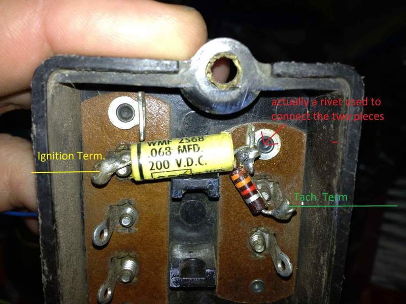

Ok let's start with what I have.
I have a 1960s era Stewart-Warner 970 series tachometer in my 1969 Mach 1.
It uses an "ignition monitor" model number 990B.
The monitor has a terminal for a lead that goes to the negative terminal of the ignition coil.
The monitor has a terminal for a lead that goes to the tachometer.
The ignintion coil, I think acts like a big ol' capacitor. It has a positive terminal,
a negative terminal and a big wire to the distributor cap. The coil typically puts out 25,000 to 42,000 volts
(not sure if it is DC or not, but I imagine it is )
The positive terminal of the coil is powered by ignition switch, I would imagine 12votls since that is the car's normal voltage.
The negative terminal of the coil is connected to the distributor's points. When the points close I guess the
circuit closes and let's loose the high voltage from the coil.
I opened up the monitor and was surprised as to how little was inside. Actually there are TWO componets
to make the "monitor"
1 capacitor with the markings of .068 MFD 200V.D.C. It is cylindrical with a wire lead on each end. One end has a black band,
which I assume denotes the negative side.
1 resistor with the markings orange-orange-red and silver, Through research I found that it is a
3.3KOhm resistor. Currently it meters out to 3.6 KOhms
The circuit goes like this
Neg Coil → neg end Capacitor → resistor → tachometer
My questions are these
What exactly are the componets doing?
How bad is that the resistor rated for 3.3kohm is actually reading 3.6 kohm?
Through my research I think the capacitor is changing the voltage from A/C to D/C
and supplying a constant voltage. Not sure why the rating of 200V.D.C. seems a high to me.
No clue what .068 MFD really is, I know it is Micro Ferrands, but that is still greek to me.
I am guessing the resistor is steppiing down the voltage, not sure if there is a formula that
given a voltage on one side of a resistor will produce x amount of voltage. Hence the questions here.
Anxiously waiting for your expert teachings.
Chris

No. Resistors usually have a 5% or 10% tolerance which is the +/- error in their intended values. The strength of the input signal won't affect the calibration a long as it is in the right range. The Tachometer probably feeds the signal through a transistor circuit to trigger a controlled current pulse which is smoothed out by filter circuits to a relatively constant current. The physical meter is then an ammeter. In short only the frequency of the pulses affects the tachometer.
Is the ignition coil more like a step up transformer from 12v to 25k+v rather than a capacitor? That would make sense.
Yes, that's correct. It is exactly a step up transformer. But designed for pulsed output rather than sinusoidal.
What does the value of .068 MFD really mean? What is a micro ferrand?
That's farad. A farad is a unit of capacitance which relates the charge stored in the capacitor to the voltage. If C is the capacitance then the charge is Q=CV where V is the voltage.
So the capacitor ensures a D/C current going to the tach right? The black band denotes the negative side of the capacitor right?
No the capacitor ensures that only AC is going to the tach, in particular only the transient pulse and not the 12V steady voltage that the coil uses to "charge up".

wow Jambaugh that was in depth explanation.
I thought I 'd attach a picture of what the pieces look like.
Is that black band on the capacitor the negative side?
Thaks for letting me know that the resistor's reading is fine....scared me abit.
if the cap is producing a/c and the ignition terminal is producing 12v DC, is the resulting AC 12volts too?
I need to go back to school :-)

The black stripe -
That type capacitor is insensitive to which lead is positive or negative.
A capacitor is made from two strips of foil, separated by an insulating film and rolled into a tube.
The two lead wires are each connected to one of the foils.
The black stripe indicates which end connects to the foil that's on the outside of last wrap.
It's not important in your application which way it goes.. Were it a filter, the outside foil ought to be the one grounded.
