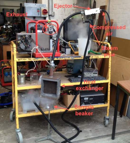

I'm doing an experiment and i'm using wallpaper stripper as my steam generator. So in the end of the experiment, i want to turn the steam into water and i'm having difficulty on this.
I tried to release the steam into the atmosphere but it didn't condense that much. The steam is disappearing in the atmosphere. Also i tried to make my pipe longer but it didn't work as well.
So what i want is a process that condenses steam to water.

I'm doing an experiment to capture the soot from exhaust pipe using steam method.
So what i want a sample of liquid that has steam and soot. All my experiment process is going well only the part of changing the state from vapour to liquid. And I reduced the soot temperature to 100C which also mixed with steam. Only when i release it to atmo it gose and i won't get that much of liquid.

Feb21-12, 09:55 AM
P: 12
Guilty Spark
i'm using compressed air as well. See the attached file and u can see how the experiment looks like.
you can see from the pic compressed air going into the ejector and also the exhaust gas. When they release form the ejector the steam will be joined and mixed.
Then the soot with steam are going into the heat exchanger.
The reason that i have tube underneath the steam pipe end because i'm having some water coming out from wallpaper stripper.
My aim from this experiment is to capture the particulate matters and measure them by using different measuring methods.
I'm investigating the particulate matter.
So any better ideas for the cooling part :D

The soot is from combustion of the engine, being captured by the steam in order to filter it out.
Maybe take a look at this: http://upload.wikimedia.org/wikipedi..._Condenser.png
It runs cold water through and the steam condenses on the cold pipes inside. Pretty much how an air conditioner makes so much liquid- water vapour is chilled on the coils and condenses to liquid.
Interesting setup, but im still confused as to how it works?
I would say you should get yourself a good electric kettle, strip the heating circuits out and put them in a well made pressure vessel with LOTS of safety precautions. Blow off valves, a safety cage, ground fault breakers. Then you can do away with the compressed air, as you have pressurized steam.
**Note that if you are going to hurt yourself please don't attempt this, I have done such things before so its up to you whether you think you can do it in a safe manner!
For test purposes ice water would be ok going through the radiator, then if you find it works perhaps move on into ac systems/
