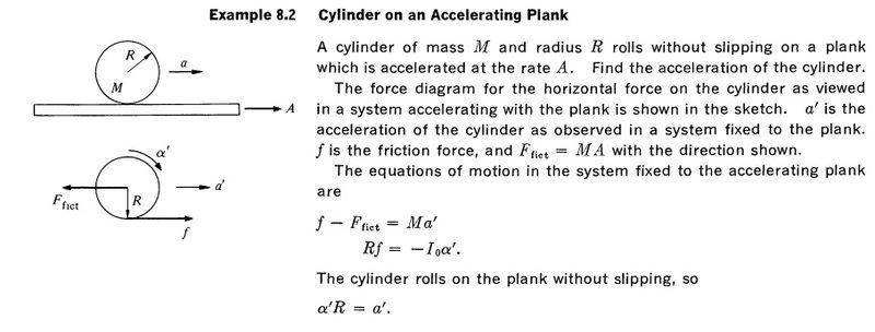

Problem is described in the picture
I do not understand how can [itex]\alpha^{'}R=a^{'}[/itex].
The dimensions do not seem correct. Angular velocity x distance from the origin = tangential velocity, is that correct ? How can this equal acceleration then ?
3. Attempt to solution
I think that [itex]\alpha^{'}R=a^{'}[/itex] would hold only if we would consider a unit time. That is:
[itex]\alpha^{'}R=\frac{d\theta}{dt}R[/itex], which, more by knowing the anticipated result in this case, than by logic, gives [itex]\frac{d\theta}R = a^{'}dt[/itex] which is now dimensionally OK, I think...
Hi Leb! :smile:
The dimensions do not seem correct. Angular velocity x distance from the origin = tangential velocity, is that correct ? How can this equal acceleration then ?.
No, a is (linear) acceleration, and α is angular acceleration
s = rθ
v = rω
a = rα :wink:
Thanks tiny-tim !
It was strange to see an alpha instead of omega, but since the author was at times using random notation (such a ro, for distance and w for density...) made me forget about usual notation:)
