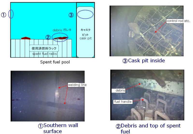

http://www.meti.go.jp/earthquake/nuclear/pdf/120328_02w.pdf Underwater preliminary survey into spent fuel pool for the purpose of debris removal, unit 3
[page 2]
1. purpose
* For fuel removal from unit 3 spent fuel pool to become a reality, it is necessary to remove debris from the reactor building top part and from inside the spent fuel pool.
* Then, for the purpose of building resources to build up the debris removal plan, an underwater preliminary survey is performed.
* The first survey is planned in mid-April. After that, surveys will be intermittently performed in response to the debris removal situation.
[page 3]
2. outline of the survey (planned to be performed in mid-April)
* using a crawler crane, a fixed type underwater camera is remote controlled from the control room in the seismic isolated building, and photographs of the spent fuel pool top part and of inside the pool are taken
* we plan a 3 day long work (preparation: one day; real work: one day; clean up: one day)
