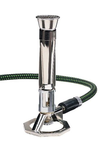

the fire was being fed from a large Lab bunsen burner, similar to this,
And was fed an constant stream of propane. As for the flow, I was not worried about this, for all I needed was a consistent height flame for the tests.
