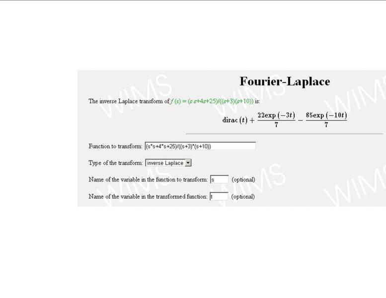

Apr12-12, 06:09 PM   #4
Is this transfer function unstable?
Does this make sense? I used an on-line program http://wims.unice.fr/wims/en_tool~an...aplace.en.html

Apr13-12, 08:10 AM   #5
Cognitive.....
Don't forget that your transfer function is a mathematical equation that will give a gain and phase angle at any given frequency from 0 to infinity.
G(s) = (s^2+4s+25) / ((s+3)*(s+10))
Simply replace "s" with "Jω".
G(s) = ((Jω)^2+4(Jω)+25) / ((Jω+3)*(Jω+10))
So when ω=0 for example.......you get 25/30.....or a gain of .83 (-1.61 dB) at your lowest possible frequency.....also your phase angle will obviously be zero since all the "J's" went away. And yes, this corresponds exactly with the graphs you show in your first post.
Take ω to equal 10 for example. Now you will get a magnitude with it's phase angle once you simplify all the J's. Don't forget that J simply equals 1<90.
Plug in any value for ω and you will always get the exact magnitude and phase. It's a real help when you get "stuck" at certain points in your bode plot. Your program may not always be available....like during an exam.
