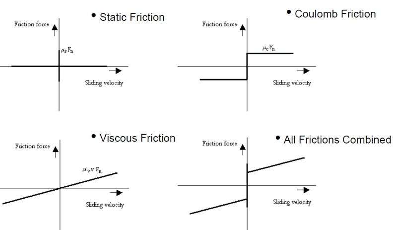

OP, I think the author is referring to static friction specifically. There is also a constant coulomb friction, a viscous friction that is proportional to velocity, and another component called the stribeck effect. When the friction initially drops from the static friction point as velocity is non-zero and then rises again from the viscous friction, the friction is showing the stribeck effect.
See the attachment, you might find it interesting.
