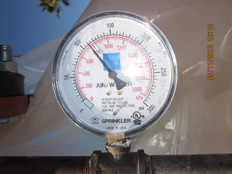

Thanks everyone for your response. This makes sense. We are going to keep the air in the system through the weekend to see if it drops by Monday. 110psi of air input 8AM on 5/10/2012. 110psi still holding at 4:30PM on 5/11 (1,000ft x 8" line)
If there is a pin hole, I wonder how long it would take for the guage to drop 5 to 10psi of air. I will see what it looks like on Monday.
Meanwhile building will be under fire watch since there is no water.

Quote Quote by Battlebreaker View Post
Thanks.
Ed
You already know there is a leak, so why re-pressurize with air??
