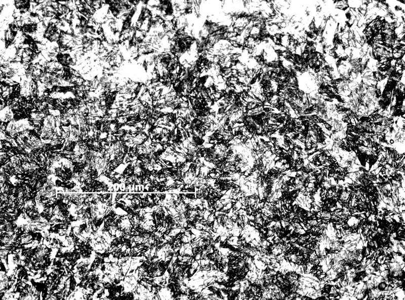

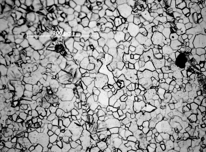

hey, everyone,
i am really confused about microstructure of titanium,one is deformed and one is original both of them is 20x, have a look at the image attachment,
i know that the grey scratched is twinning and slip marks due to deformation, what about those white parts and black parts?
thank you....

Is this Cp-Ti (commercial purity) or another alloy like Ti-6Al-4V?
I'm guessing it is Cp-Ti because the first picture looks like equiaxed grains of alpha-phase.
The second image looks like widmanstatten phases. Was there a heat treatment on the alloy?

hi streeters,
thanks for helping, but this section is done,
the lecture said that...it was relatively pure titanium, the reason why lighter/darker region is due to its own orientation.
i feel it was not very good explaination, but it fits her marking scheme so m gonna settle with that.
