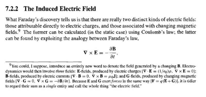

A changing magnetic field induces a field, G:
∇×G = -∂B/∂t (1)
Now my book then says, since ∇×G≠0 while ∇×E=0 and ∇[itex]\cdot[/itex]G=0 while ∇[itex]\cdot[/itex]E ≠0 we might as well see G and E as the same field, and thus see G as an induced electric field.
I can understand that, I just don't understand how one finds that ∇[itex]\cdot[/itex]G≠0. My book says it is because there exists no source charges, but I find that a bad argument since the fact that E is not divergenceless comes from the mathematical nature of Coulombs law rather than the source charges.
So my question:
How does one show that the above law (1) means that E is divergenceless?

I think you misunderstand what I am saying, so I will refer directly to my book (Attached picture), which is Griffiths.
My question is: How does he conclude that the field induced by the changing magnetic field has zero divergence?

It is defined that way, so E+G will satisfy the ordinary Maxwell equations, which we know to be true. We know that the source term in the divergence equation represents electric charges, so the splitting of the electric field that is mentioned in the book is simply defined so as to have a vanishing source term in the divergence equation for G, so we can say that one part of the field is caused by electric charges, while the other part does not...
You should conclude that [itex]\nabla \cdot G = 0[/itex] because [itex]\nabla \cdot (\nabla \times A) = 0[/itex] for any vector field [itex]A[/itex].

But it is not stated in the assumptions on that page that G is the curl of some vector field A. As far as I can see, this all boils down to a convenient definition for a splitting of the electric field.

Okay, I'm not good enough to understand all of that unfortunately. But from what I can get you are using the fact, that you can always make a vector potential divergenceless - or putting it another way: The Faraday law specifies the curl of E, not the divergence, to which we are at liberty to assign any value, zero being the smartest.
No! There's another Maxwell equation specifying the divergence to be the charge distribution (Gauss's Law!).
