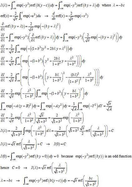

Hi !
in attachment, a method for solving the definite integral.
Jun17-12, 05:02 AM   #7
Hi JJacquelin! Your post helped me with showing that the constant of integration [tex]C=0[/tex] in a more general formula:
[tex]
\int_{-\infty}^{\infty}\exp\left(-b^{2}(x-c)^{2}\right)\mathrm{erf}\left(a\left(x-d\right)\right)\,\mathrm{d}x=\frac{\sqrt{\pi}}{b} \mathrm{erf}\left(\frac{ab\left(c-d\right)}{\sqrt{a{}^{2}+b{}^{2}}}\right),\quad b>0
[/tex]
Thank you!
