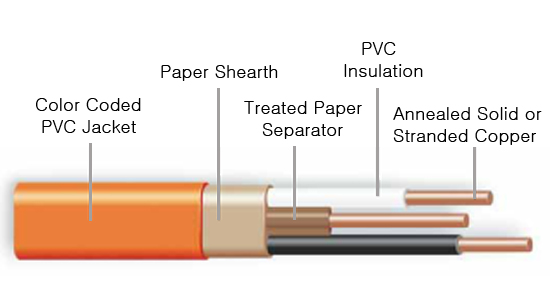

My Led's are powered off the AC wall switch then thru a a .39 capacitor then bridge rectifier they will burn forever even when switched off and when it is completely dark you get enough light to see. I have read that this is like laying a spool of copper wire under a high voltage transmission line and connecting a bulb and it will burn. It seems to me that the power is jumping across from one hot wire running parallel with the wire coming off the switch. I was just wondering if current is lost or being drawn of the live lines this way if you actually pay for this or is the current or energy that would have been lost anyway?

i'd guess like you, it's capacitive coupling between the two wires going to the switch.
in theory you pay for it, in reality it's probably like 1 / 100 of an amp so way less than a watt.
It won't cost you more than eighty-seven cents per year even if your meter is able to detect it.. just call it a night-light.....

well, think about it.. if the two conductors going to the switch have capacitance between them, as they do in typical houswiring
that capacitance shunts a feeble current around the switch. It may be enough to give an LED a feeble glow .

Hi Jim. This is particularly true for wires in a "two way" switch. Here you can often get a fairly long run where the "dead" wire runs directly in parallel (usually in the same cable) with a live wire. My back of the hand calculations suggest that you could get about one nF of coupling there and a corresponding parasitic current of about 50uA. Probably enough to dimly light a high efficiency LED.

That's what it is and a 100 watt light bulb running on AC would give off light to, but it is to big of a load to see the light, but do you pay for this type of current or would this type of current have been lost anyway even if there was no light in the socket? Also in house wiring it does not only have to be two way switch just the hot wire coming down to the switch along side the wire going to the light will be close enough.

These phantom currents all go through your power meter, along with other household current, so potentially will contribute to your power bill. If the stray currents perform real work, then that inevitably gets metered the same as any other V.I.cosɸ component.
It should be possible to establish whether the long run of cable with its capacitive coupling is seen as an overall inductive load or capacitive load. If capacitive, then it will provide a tiny bit of power-factor correction to a normally inductive home circuit. This can be expected to slightly raise your mains voltage and, along with it, your household current, albeit by a miniscule amount, but still it's a rise so reflects as a fractionally higher power bill. However, if the cable proves to be an inductive load, then the converse scenario applies.
