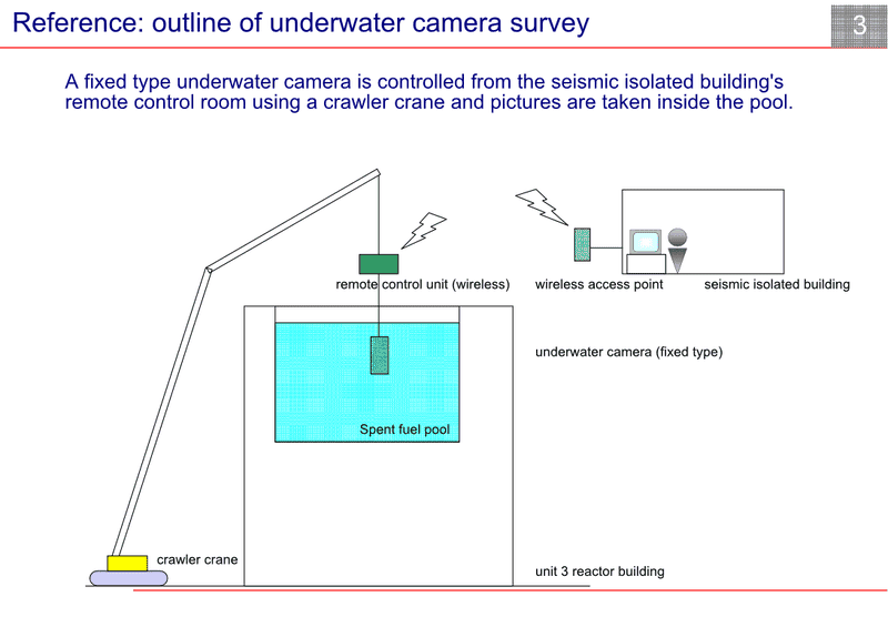

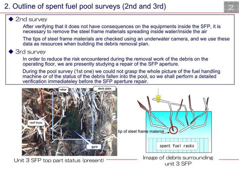

Jul3-12, 03:10 PM   #13517
Engineering 2012
Recognitions:
Gold Membership Gold Member
Science Advisor Science Advisor
in this document linked above (thanks again Tsutsuji )
http://www.meti.go.jp/earthquake/nuc...120625_02y.pdf
there's two red circles on bottom left photo.
800 % is about all the expansion it'll stand, and i dont see what is significant there.
Except that a lot of debris has been cleared.
is there anything i'm missing by my inability to read the captions ?
old jim
Jul3-12, 03:29 PM   #13518
No you aren't missing anything, debris removal is all its about. In this case they finally dealt with the roof debris thats been dangling down there, having previously cleared away rather large quantities of debris & broken buildings from the area below.
Since I was asking about progress at this reactor the other day, I am very grateful for the translation above which gives us a sense of timescale, as well as these new images.

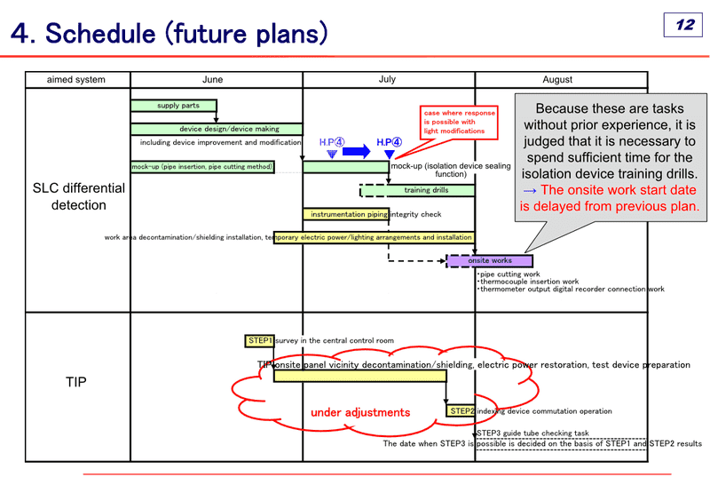

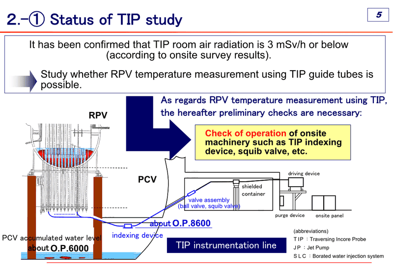

Thanks very much, thats the one, not sure if there are any others.
Anyway I guess we aren't going to learn much more about this for a long time, and there is little else that I can use right now to build on any theories in this regard. I suppose alternative possibilities are core material washing down into S/C or torus room later, or something related to wet venting.
The next thing we might learn about reactor 1 is the state of the TIP room, and updated measurements of previously inspected southern parts of the first floor, as they are due to do the robot thing there on wednesday according to this handout:
http://www.tepco.co.jp/en/nu/fukushi...20703_01-e.pdf

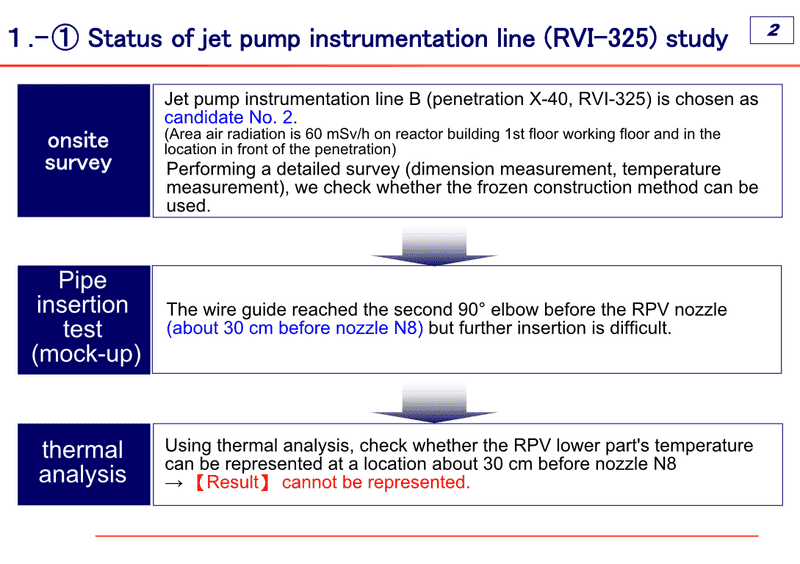

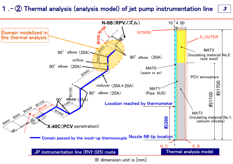

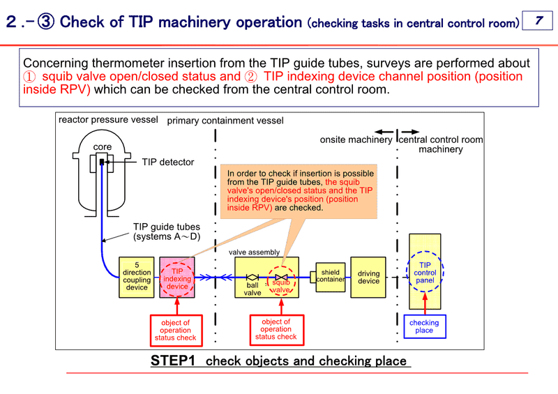

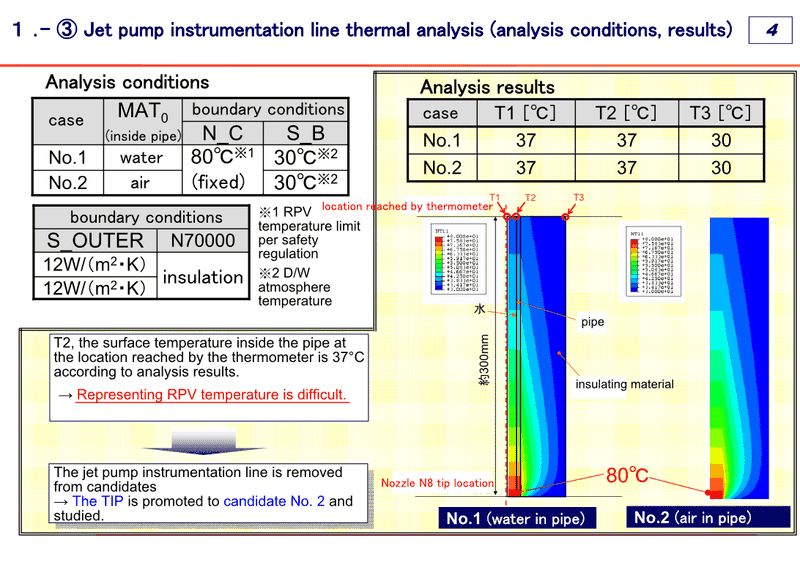

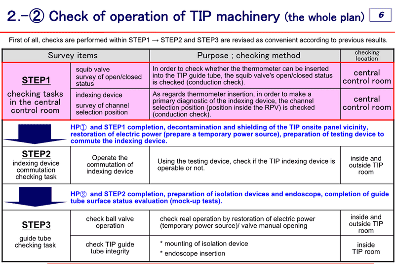

2) Translation:
01/12
02/12
03/12
unit 2 alternative thermometers 01of12.png   unit 2 alternative thermometers 02of12.png   unit 2 alternative thermometers 03of12.png
Jul6-12, 02:51 AM   #13524
Nuclear Engineering 2012
Recognitions:

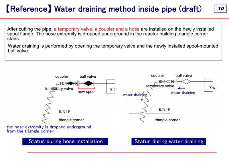

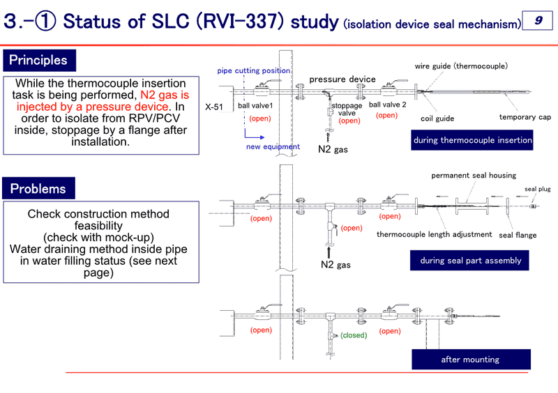

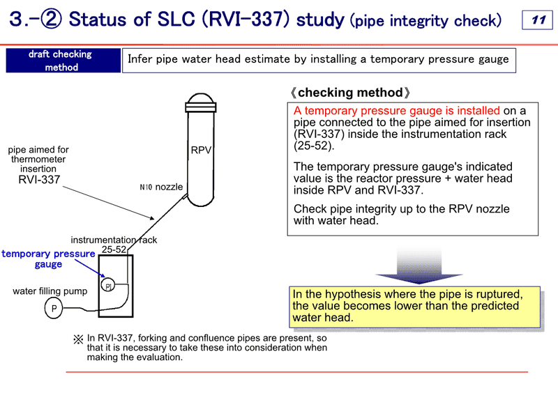

Translation:
04/12
05/12
06/12
unit 2 alternative thermometers 04of12.png   unit 2 alternative thermometers 05of12.png   unit 2 alternative thermometers 06of12.png
Jul6-12, 02:54 AM   #13525
Recognitions:
Translation:
07/12
08/12
09/12
unit 2 alternative thermometers 07of12.png   unit 2 alternative thermometers 08of12.png   unit 2 alternative thermometers 09of12.png
Jul6-12, 02:56 AM   #13526
Recognitions:
Translation:
10/12
11/12
12/12
unit 2 alternative thermometers 10of12.png   unit 2 alternative thermometers 11of12.png   unit 2 alternative thermometers 12of12.png
