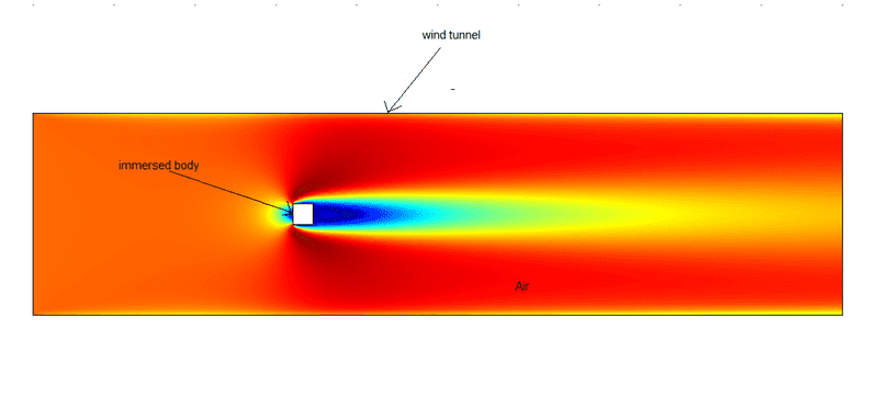

hi boneh3ah ,
I had a network connection problem yesterday the attached photo is about the model I calculate the Cd & Cl for it. I'm testing the variation of many parameters on Cd & Cl ( Air speed, square side dimension , tunnel height) also, the shape ( square , triangle) the fixation points are in the middle of each side ( four fixation points ) & they are also the points which I measure the reaction forces on them. I'm using Comsol multiphysics program for simulation problem. thanks alot |

Like I said, do a search through the literature. I remember seeing a JFM article about calculating lift and drag on a square cylinder, but I personally am not all that familiar with this particular flow problem so I can't tell you all that much.
What I can tell you is that your simulation appears to be steady and laminar based on the wake and this is a highly unsteady phenomenon. |
