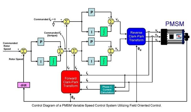

I found a better picture of a FOC controller.
Here you see the inner PID loops, controlling current.
And the outer PID loop controlling speed.
The rotor position is needed for the transformations.
The output of the inner PIDs control the PMW, thus controls the voltage on the motor windings. The voltage is propotional to motor speed, not motor current.
So why is the current feedback and not the speed?

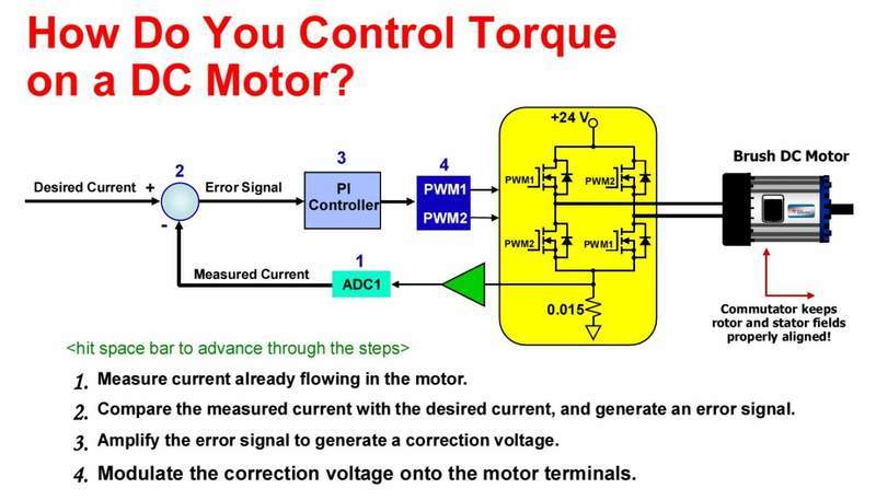

Jul31-12, 02:18 AM   #13
I found a better (much simpler) controller diagram to explain my question.
See attachment again.
Here the torque (is current) is controlled by a PI controller. The output is a voltage.
The PMW makes sure this voltage is applied to the motor.
But the motor current is feedback to the PI controller!
I do not understand this.
The voltage on a motor is more or less proportional to the motor speed. So it makes more sense to me to feedback the speed. The voltage will increase or decrease the current because the motor is an inductor. So the voltage gets mathematically integated. How can a PI controller work with this (integrated) feedback?

In your DC motor example, most recent post, ...
why can't two integrators be cascaded?
just their time constants need to be separated ..
and - feeedback is measured current and is compared to desired so error will be forced to zero
so far as the control system is concerned, output is measured current
and motor's transfer function is just one more term
motor coild be moved inside yellow block
try thinking of the motor as a first order lag instead of an integration
because it really does have an L/R time constant so will not integrate for very long.
any help?

So what you are saying is that you can control the motor current by controller the voltage in a more or less proportional way. And the integrattion will not disturb the PID controller?
Jul31-12, 08:21 AM   #16
As you see in the example you provided, the PI controller block diagram has the conversion built into it.
Jul31-12, 08:26 AM   #17
Quote by mechamania View Post
Applied voltage is not directly related to motor speed. It is proportional, but the actual speed is dependent on other factors too - the current/mechanical load.
It is the back-EMF that you need to think about. And the back EMF is the parameter that is dependent on the angular velocity of the rotor. It fights with your applied voltage as an inherent negative feedback, and when the motor is producing higher torque, the back EMF has decreased for the same applied voltage. Your current relationship comes in to play here, as this back-emf reduction causes a larger voltage drop across the windings -> more current through them. The parameters are all related by equations, so it is not magic that you can control the current with the voltage.
Saying the motor is an inductor really does not have much importance with the current/voltage relationship other than the back EMF effect. The inductor aspect is more important for understanding electrical transient behavior of the motor, about just as relevant as the internal resistance of the motor as far as your original question goes.
The answer to your question really boils down to following the units conversions in the block diagram path. Like I said, it is a conversion factor that is built into the closed loop somewhere that translates an applied voltage to the motor's current.
