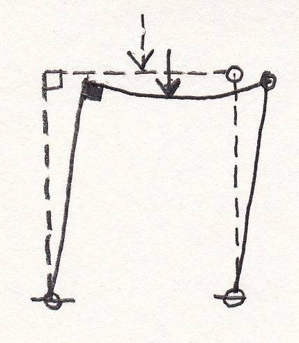

Also another question regarding the same problem ,assume i have a beam and the internal support is pin, if we draw the deflected shape it will deflect and gives theta, right….., but imagine you have steel column connected to left beam and right beam by connection at web of beams (which means pin connection), here the right column will deflect and gives theta different than the left, while as i said previously in analysis, it deflect as one unit with one theta, so please explain this in details

A rigid joint is one where the members that frame into the joint do not rotate relative to each other at that joint. If a member frames into another member say at a 60 degreee angle, they remain at 60 degreees to each other at that joint under loading or rotation or translation of that joint. I'm not sure about the handbook question...not all joints are rigid, like when a beam frames into a column and is attched to the web of the column with clip angles, it is assumed pinned, in which case if the angle between them was 90 degrees before loading, it is no longer 90 degrees when the beam is loaded, it would be slightly less.

I don't know if this helps but I have attached a hand sketch of the exaggerated deflection of a 3-hinged arch in which the left hand knee is rigid and the right hand knee is pinned. The exaggerated nature of the sketch shows the beam bending, but also a small sway to the right to accommodate the difference in behaviour between right and left sides. In interpreting this figure it is important to distinguish between first order displacements (central deflection of beam bending, and beam end rotations) from second order displacements (lateral sway, column bending). Practically the columns remain straight.
